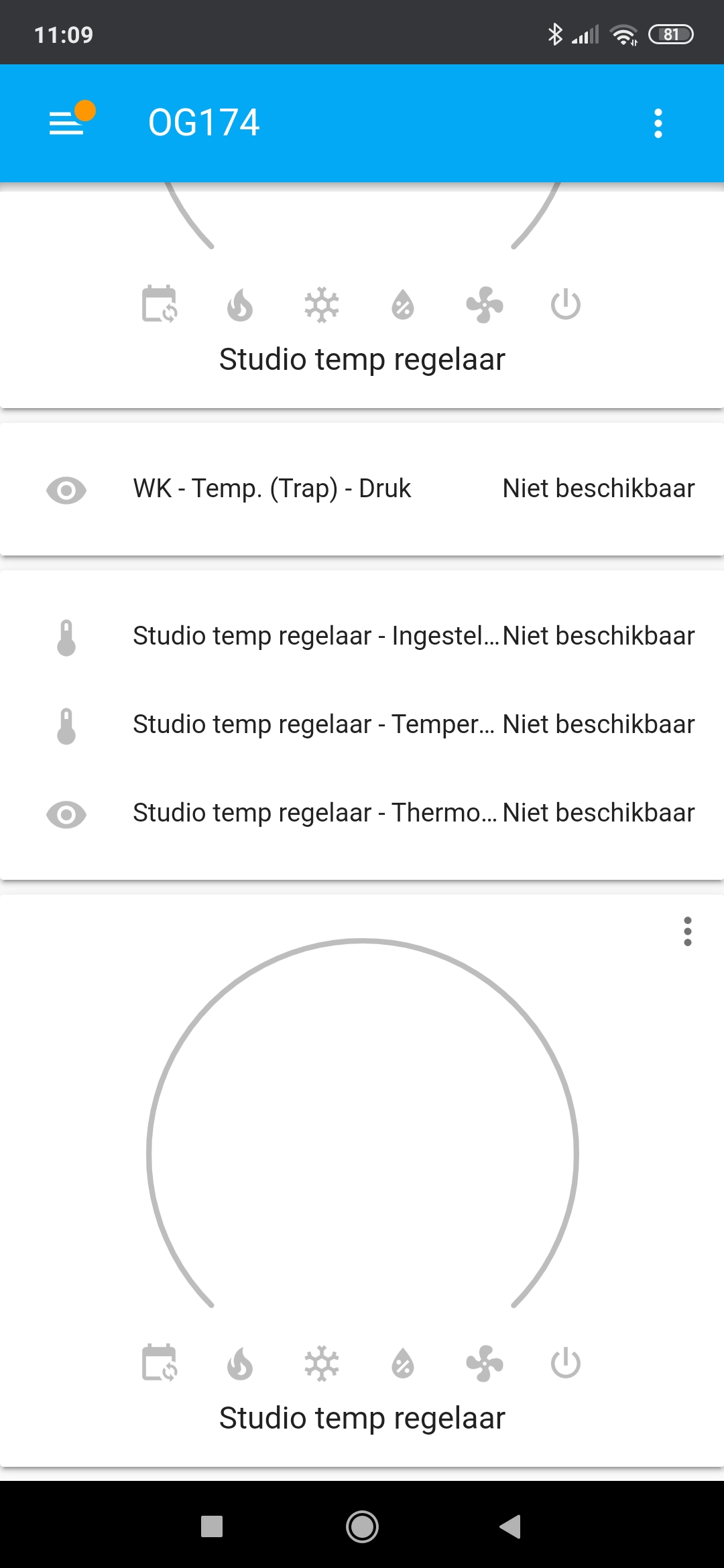

I added some devices to the main screen, but still no data is shown:
