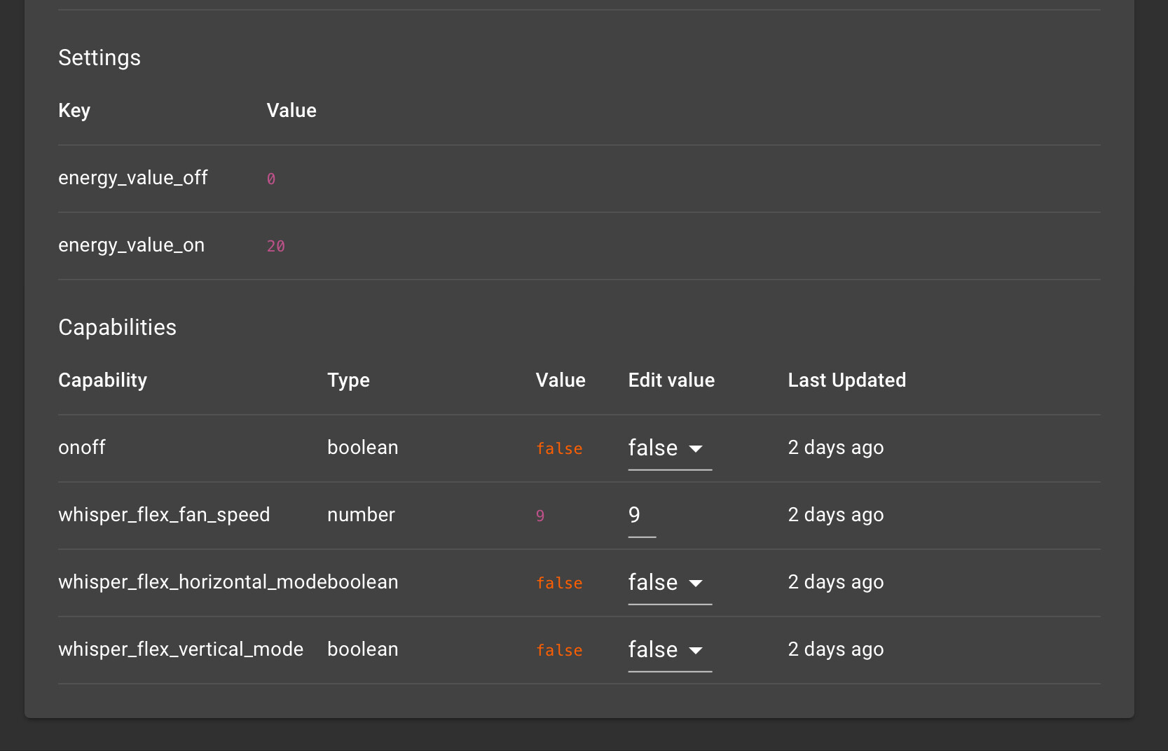

Whats the capability definition as displayed in the developers dashboard?
https://tools.developer.homey.app/tools/devices
It needs to be setable to be able to control it. This needs to be implemented by the Duux smartfan app.

Hmm, looks like the fan speed is editable from there…
Are you able to control the fan from de developer tools?

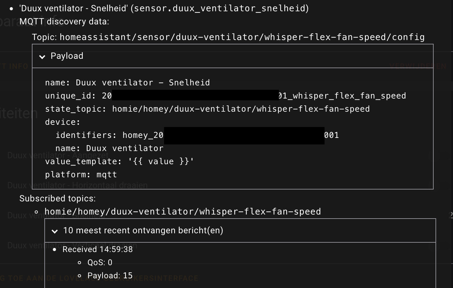

Can you show me the homeassistant /config for the fan (mqtt HA discovery topic)?
And is there an HA input_number available for the fan?
Yes, I have now discovered that the fan speed is settable from the developer site.
I hope this is what mean (sorry if not…)?
Eeeehhh….? :wink: Should it be in the screenshot above? If so; then there isn’t…
There is only a state_topic.
Shouldn’t there also be a command_topic?

Try mqtt explorer?
Found that one too, I hope… :wink: Hope this helps?
(cannot scroll to the right, but if it helps, I would be more than happy so send more screenshots)
I see command_topics for onoff and horizontal- & vertical mode, but not for fan-speed.
But that one is registered as a sensor, the other ones are switches, so that’s the problem perhaps?
Dug a little deeper. It’s probably a shortcoming of the MQTT Hub. The homey device is clearly labeled as a ‘fan’ (device class; first screenshot).
The hub should translate this into a HA MQTT fan config. But it’s provided as a sensor, which is ready only.
