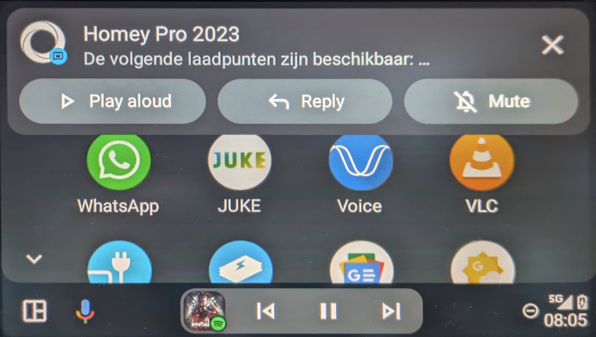

Step 4: Setting up AA Notification Forwarder
Now that the script is ready, we want to make sure it’s visible in the car. Unfortunately, the Homey app doesn’t natively support Android Auto. So, to make this work, we need to use an app that makes notifications from other apps visible in Android Auto. For this, we can use AA Notification Forwarder, which is not available in the Play Store. This is because the app doesn’t comply with Google’s policies regarding Android Auto. Google prefers not to forward notifications from non-chat services. Fortunately, it’s not very difficult to sideload apps on Android. After downloading and installing the app, it’s important to follow the steps as outlined on the Github page. If not, we won’t receive the notifications.
Once the settings are configured, we start the app. Under Apps to Forward, we search for Homey and enable it. We also enable the checkbox for Ignore Group Summary notifications.

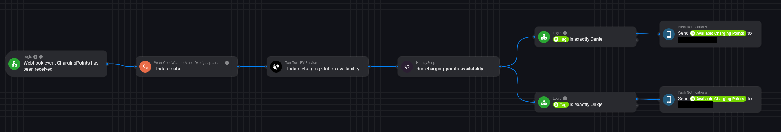

Step 6: Flow in Homey
With everything set up, it’s just a matter of creating the Flow in Homey. I used the following flow:
In the flow, the name of the webhook event matches the one from the HTTP request. The TomTom EV Services app then updates all its data with the update charging station availability card, ensuring that the most recent data is used. HomeyScript is, of course, the script from this tutorial, and tag is the custom name that we created with the GET request.
