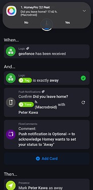

Flow:
This is the trigger card to use:
In the [Event] field, enter the my_event_name, which is geofence in this example
Now the flow looks like this;
when
my_tag=awayit would mean you left home; -
use an “And” logic card “text is exactly [text]” and enter “away” to build a switch:
- when it’s exactly
away: start “Then” cards
- when it’s exactly
- when it’s anything else: start “Else” cards
When acknowledged or without push confirmation it’ll start the “Then” cards:
- Optional:
With the push confirmation it’ll asks to continue:
- Optional:
To trigger the “back home” part, you can use the same webhook, only you should use an other tag, like,
home:
https://webhook.homey.app/61123456789123456789/geofence?tag=home
- The flow will start the “Else” cards:

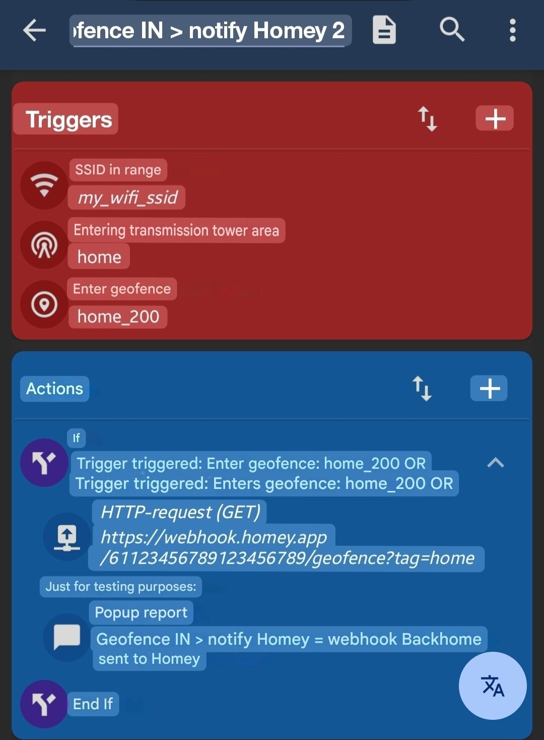

MacroDroid
Install Macrodroid
As macro trigger, you can use leaving or entering:
(a) predefined geofence(s)
the area between 3 transmission towers
(a) known @ home wifi SSID(s), in or out of reach
Enter the webhooks as http request in the action field
Leaving:
use webhook tag=away
Returning:
use webhook tag=home
