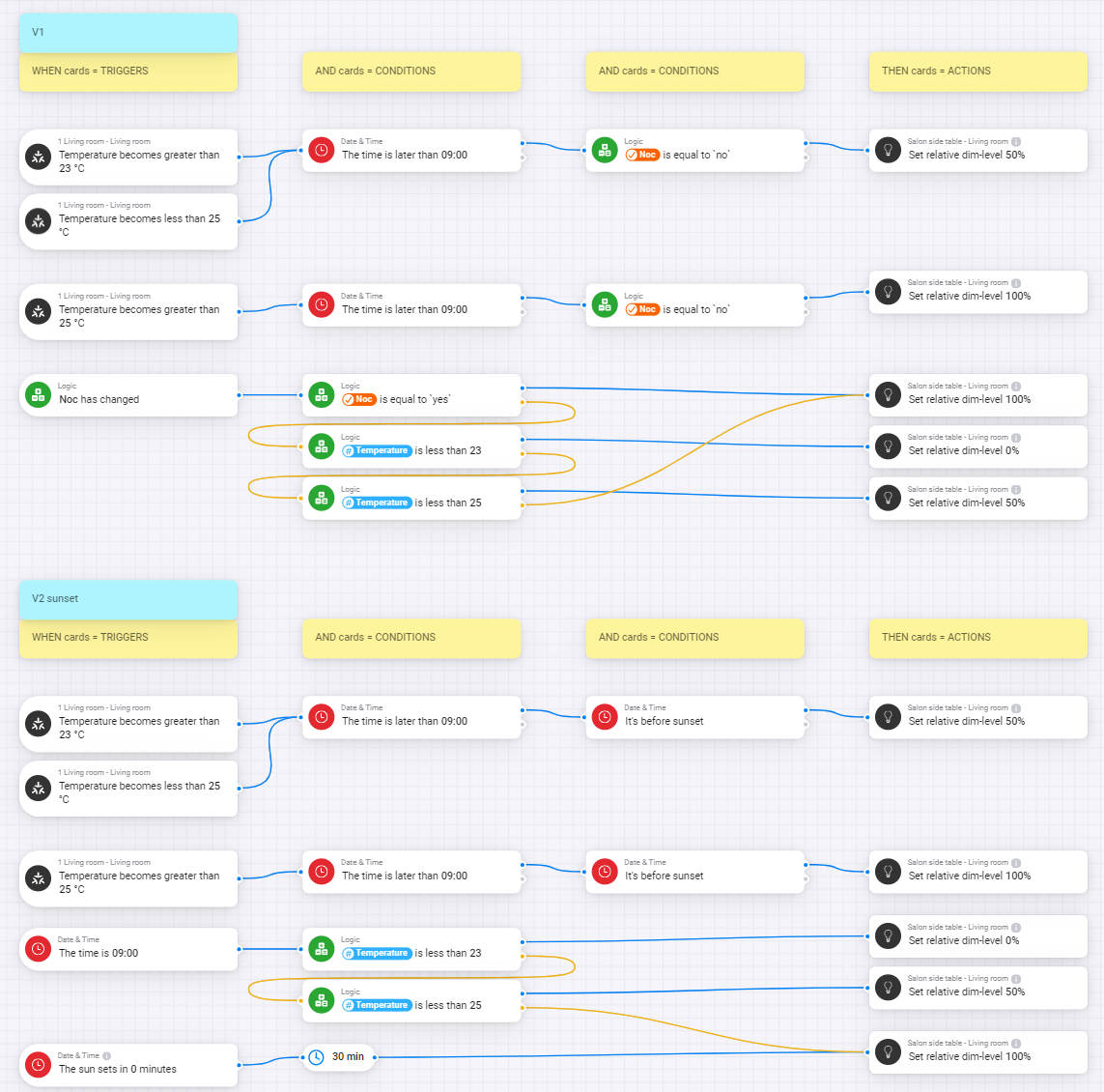

If the above is what you wanted, then below a better version where the logic is placed in the middle column and is checked after every trigger. I think it is easier to read.

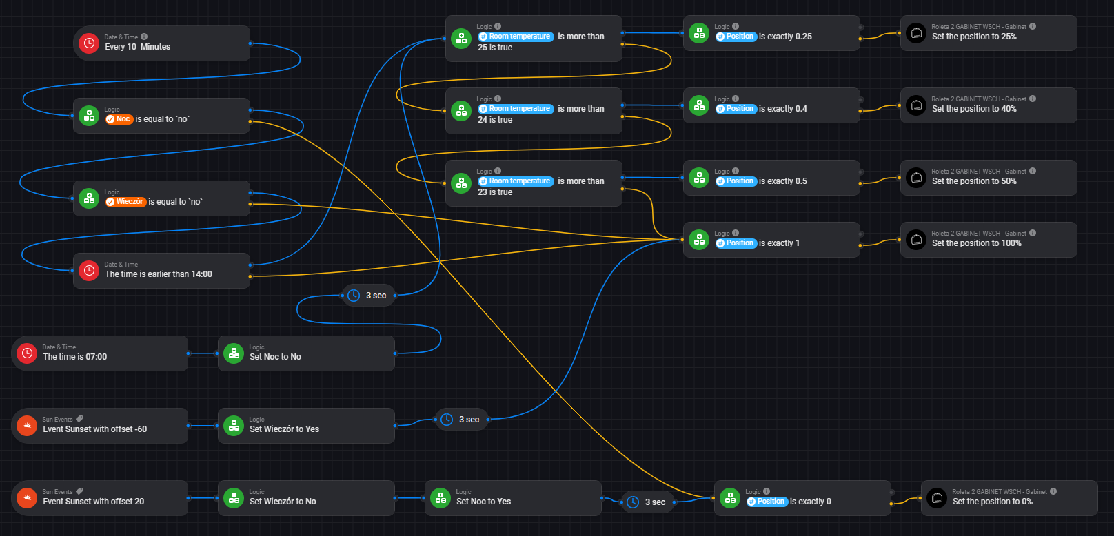

Hi @Rrrr - Thanks for above. Sorry for delay but I was not able to check it. Your suggestions are working and below you will find an example set for one of 10th my RS3.

Suggestion:

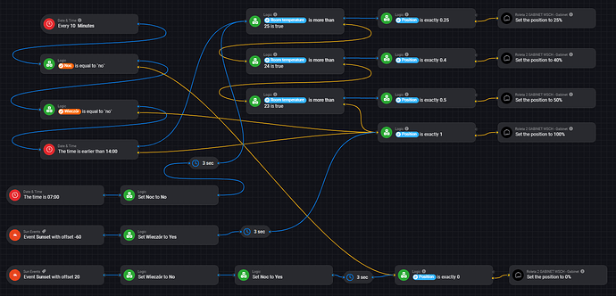

  1. Every 10 minutes could be replaced by 2 cards “When logic variable has changed” (noc/wiezcor).
  2. Switch the two logic cards here:
  3. Disentangle the Main logic from the time schedule and cancel these connections:
If this works for you it means less needless work for Homey CPU and easier to read…
