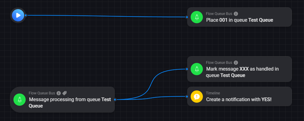

I’ve created a super simple app and tested it in a simple flow. My action card works and triggers my trigger card, but then the flow just stops.

Flow:

It never writes something to the timeline or logs “Handled Message Action.“, not even if I remove the tokens:
