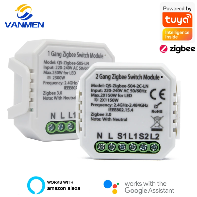

I use the Tuya smart switch which zigbee 3.0 is powered 230v and a normal switch which fits in our home design.
I still don’t understand: is the Tuya smart switch physically switching a Zigbee light bulb?
In any case, since it’s a smart switch, what stops you from creating a flow that gets triggered when the switch switches on/off and then switch the other light on/off accordingly?
The Tuya Zigbee Switch you can physically switching a standard bulb. This means even if you hub is down you can stil switch on the light. This switch is powered by 230 volt. A isolated relay to be used for ay think like fan, lamp or other item and a isolated switch input. If you close the switch you relay will be activated this is also shown on the app light is on. If I use the app to switch of the light this is possible. If I open the switch then the light will go on.

This Tuya switch does both. If there is a status change of the wall switch it changes the status of the relay. The bulb is not a zigbee bulb it can be any bulb. If I send the message switch the light on it switches the relay on and I can send the message to switch the light of the relay switches the relay off. The switch is always powered the bulb not you can not use this in combination with a zigbee bulb because the bulb will be not powered when the relay is open.
