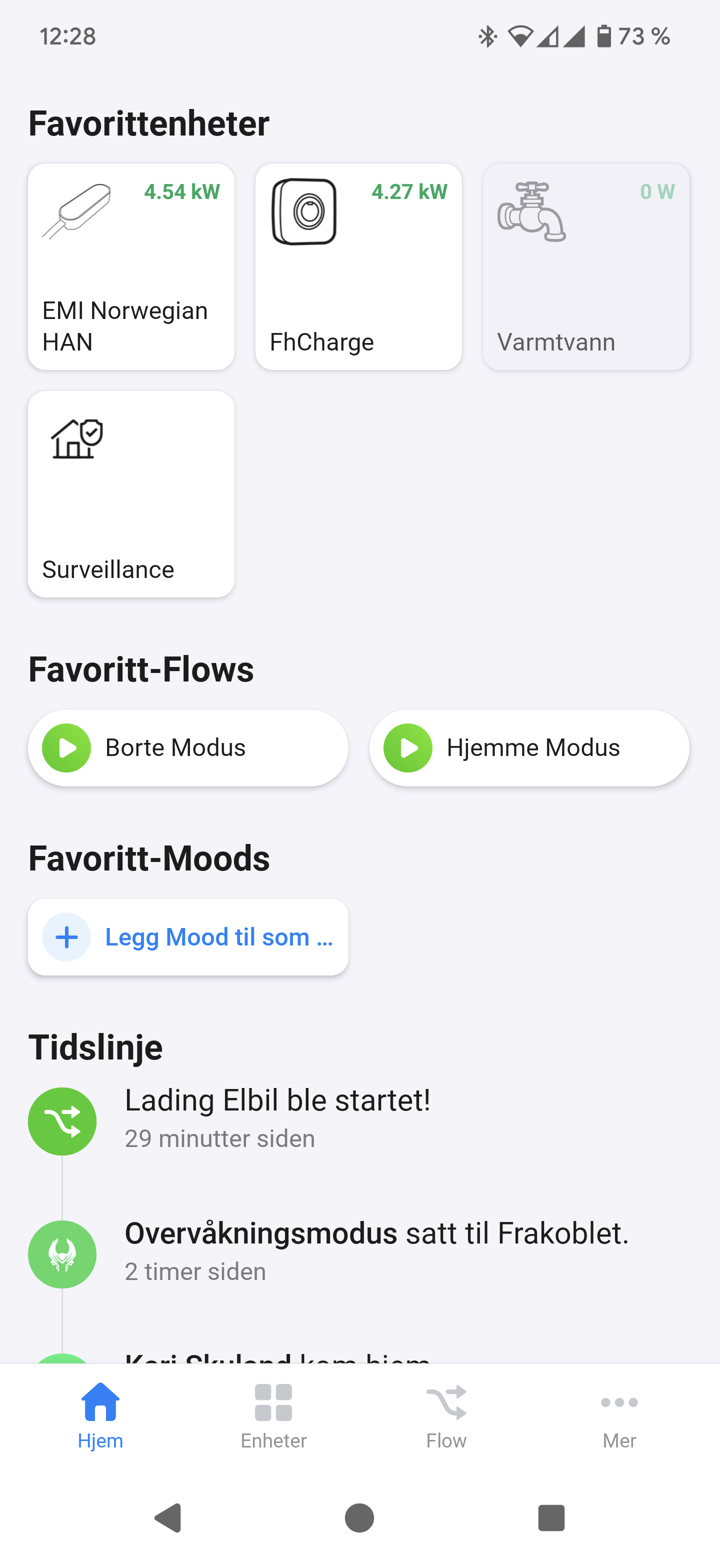

Just want to say that the FH charger is working fine. I also use the FH Han sensor added as Develco Norwegian HAN. FH Mode button also works great. Thanks for the great work.
