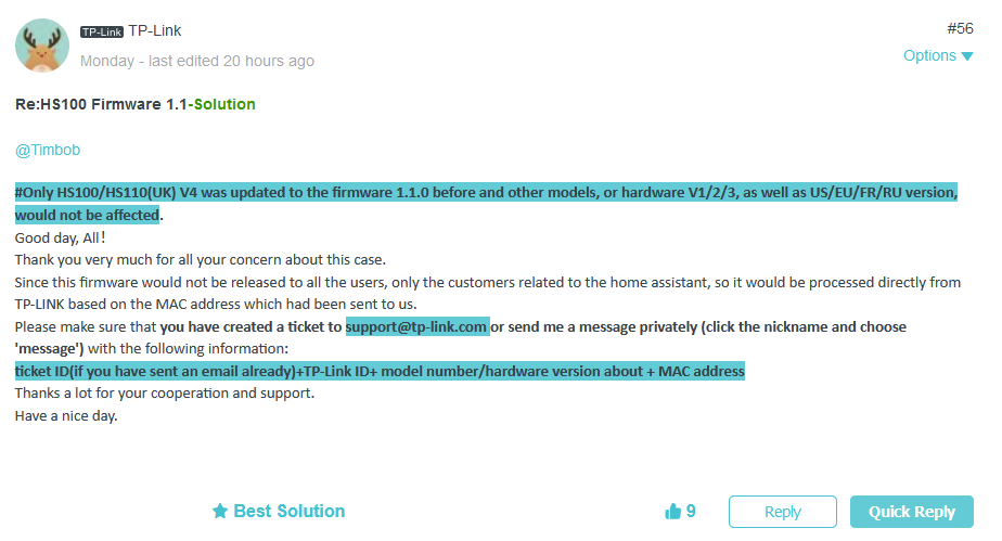

But beware :
This is one of tp-link supervisors Candice to follow up your case. Thank you for let us know your concern. We could understand your frustration as the Home assistant has been working before, but I'm afraid Home assistant does not have the privilege to manage HS100/HS110 V4 plugs anymore. The new firmware fixed the security vulnerability that may be utilized for attacks on TP-Link plugs and certain resources currently are not open to unauthorized applications for security reason. We are sorry that Home assistants was affected by that but this a decision we have to made to protect smart plugs for our customers. Besides, tp-link has not advertised the Home Assistant integration on official websites, and we can not guarantee that feature will work properly.
In case you are impacted, downgrade could be requested :
I managed to fix this as well by writing to TP-Link. Write to support@tp-link.com with a screenshot of your Device Info from the App - I think it’s the MAC Address that is key.
Support was rather quick at writing back to me - within 2 days; however, I was told to wait a week+ (date was given) before the firmware will be “pushed” to me. Anyway, I waited until the assigned date, then I found that I had to remove the device from the App, then re-install the device again; now it’s showing V1.1.1 on my HS110. WORKS with Homey as it had before.
