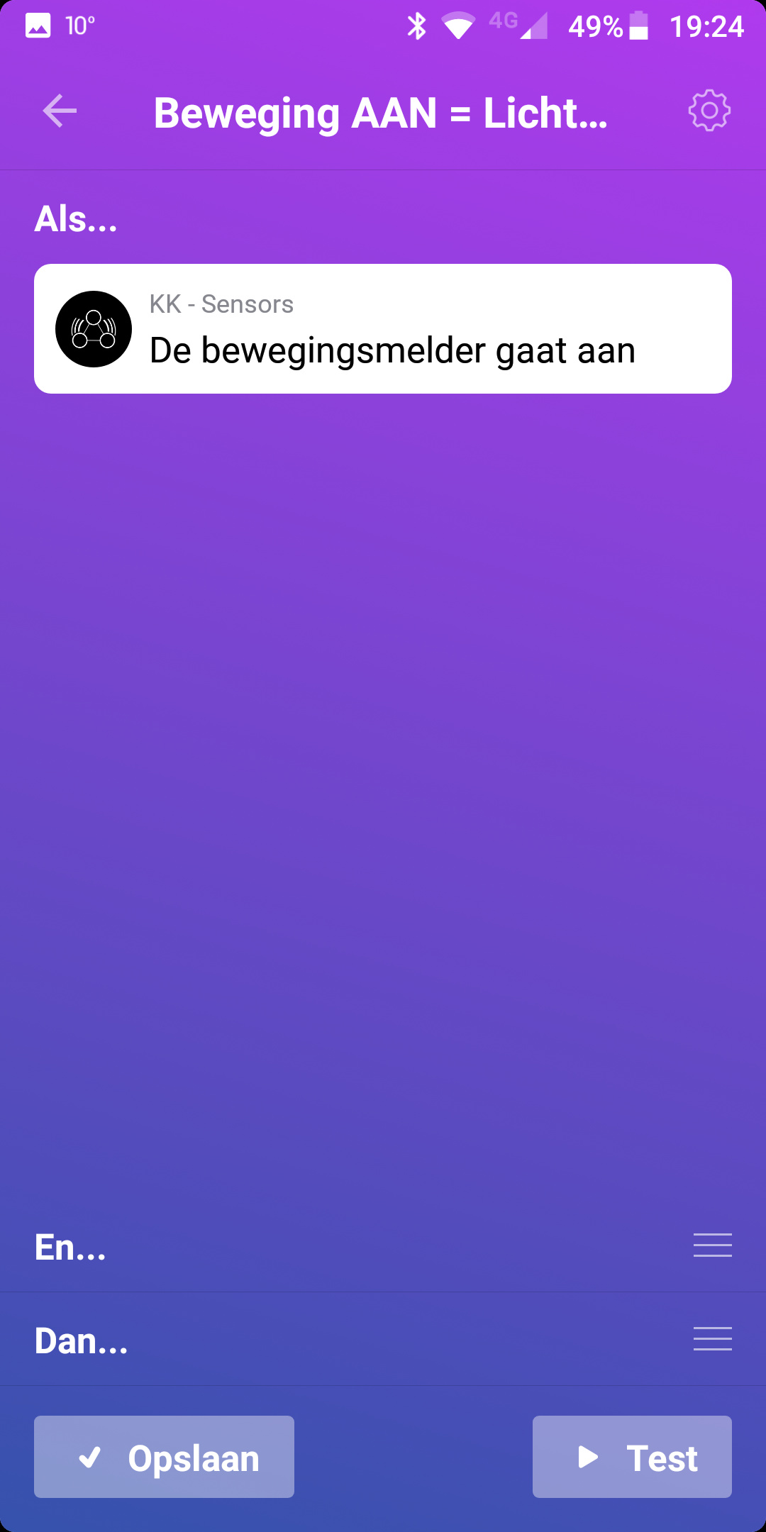

Here the trigger card with the grouped motion alarm sensors:

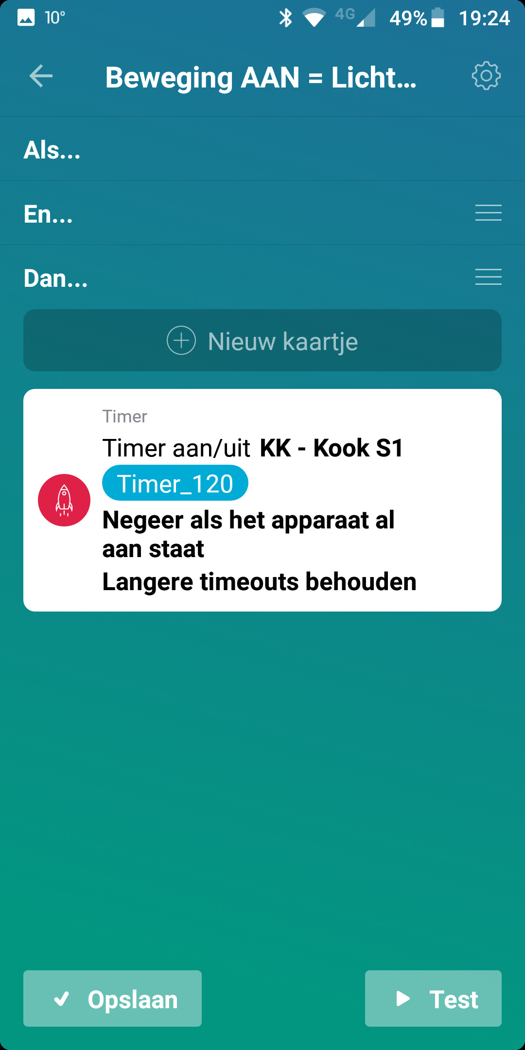

Here the timer settings in the THAN:
What am I doing wrong?

The THAN card switches on the light (KK - Kook S1) and a Timer for 120 seconds. I beliece to understand that the timer is restarted if motion alarm from the IF trigger is received.
The motion alarm devices have the alarm canceled after 30 seconds, well before the timer of the THAN card.
But I think the device will only turn off the alarm if no motion is detected for 30 seconds. So if there’s movement the alarm stays on.
If you activate motion then move clear for 35 seconds then activate motion again, etc then your set-up will probably work.
Normally the timer is stopped by the on condition and started by the off condition.
The Timer App I am using should accommodate this as a ‘all in one’ devise.
It does the on/off switching, has a timer and is capable of re-truggering.

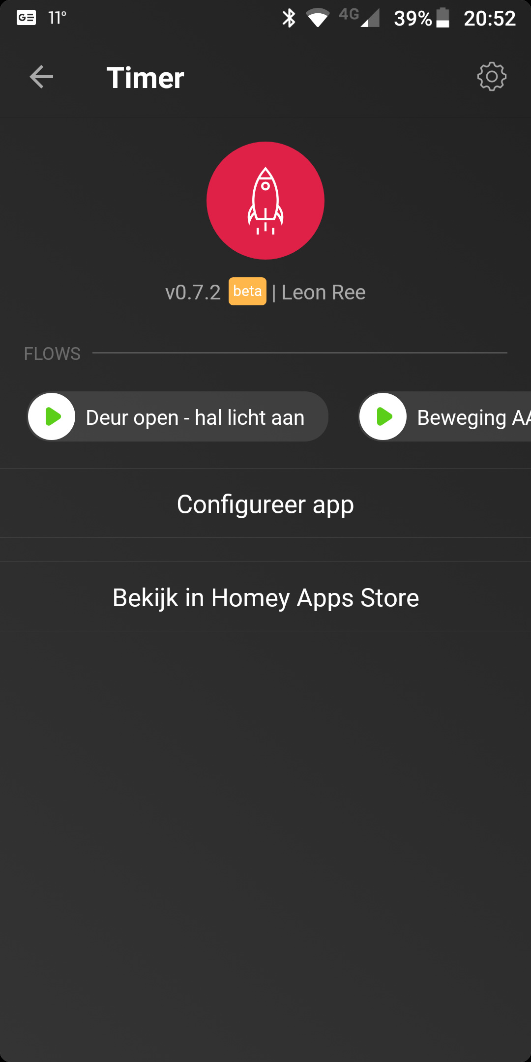

This is the App:
Looking at the app details:
TodoFind a away to handle motion started/ended triggers better, since with continious motion, the timer will end sooner than (maybe even before) the last motion.

@Eternity Can you try to change the setting “negeer als het apparaat al aanstaat” to “beheers het toch”.
I am not sure if this is impactimg the switching of the device only or also the timer.
I have my timer at “beheers het toch” combined with the motion sensor.
Works perfect
Update: just changed my flow to “negeer als het apparaat al aan staat” and still working fine.
So thats not it

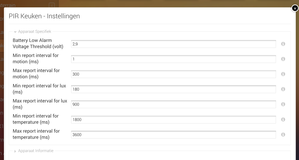

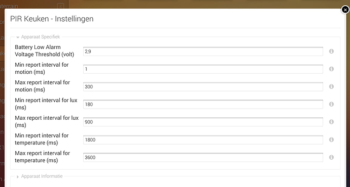

Some motion sensors (like my hue) have a setting for minimal report interval.
If you change that to a lower numer it will solve that problem. (I will start eating more battery)
Mine is default at 1s (the ms is a typo by athom) the timer is working fine.
