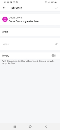

Oh i try to it with timer app
Ok so i created a timer inside the app setting
But not sure how to apply it on a flow
What do i need to write down in the value?
The 3 min i set it up in the app settings
You set the length of the timer in the flow, not in the Countdown app itself. So the value is the number of seconds.
