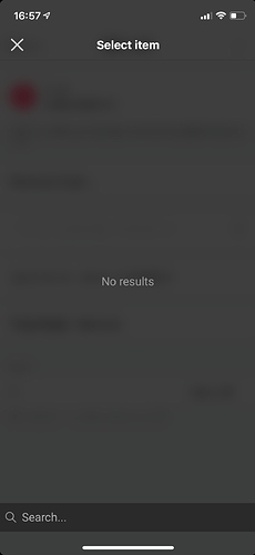

Hello Community, does anyone know why I canā€˜t select any of my devices?
Regards
Andreas
There where some bugs in 0.6.2 which caused crashes, and which could also cause empty device overviews. These are fixed in 0.7(.2) which is awaiting approval from athom…
0.7.2 is approved and can be found in the store
