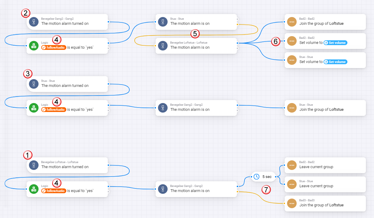

Thanks Arie_J_Godschalk. I got inspired and created my own flows and wanted to share my experience with you (spoiler alert: not all good).
Here’s my advanced flow:
1, 2 and 3 are there rooms set up for this . (1) is my office. To get coffee, I need to go through room (2) to get to room (3). The sound follows me a) if something is playing on my “Loftstue” SONOS speaker and b) I’ve set the boolean variable “followAudio” = TRUE (4).
When going into room (2) I check (5) if I didn’t come from room (3) and if I just left room (1). If so (6), I include speaker in room (2) into the group (and set volumes for speakers in room (2) and (3)).
When going into room (3), I check if I come from room (2) (and am not just roaming around in room (3)). If so , I include speaker 3 into the SONOS speaker group.
Finally when I get back to room (1), I check if I just walked through room (2). If i did (7), I wait 5 seconds then remove the two other speakers from the group.
If I just roam around in room (1), I make sure another speaker near room (1) is included in the group.
PROS: Sometimes this works. I do not think theres anything (much?) wrong with my logic, but…
CONS: …either my speakers are old (oldest >11 years) or I have other SONOS related issued, cause very often the speakers are not included into the group. I tested with “…is playing” on some of the speakers and it was really miss’n’hit if it reported back TRUE when it was playing. The simple solution is just blindly to include/remove speakers from the group regardless if something’s playing…
Added bonus: When my wife comes home, there’s a flow that sets “followAudio”=FALSE :slight_smile:
Suggestions? I’m more than open to suggestions on how to improve my flow or do you know what my SONOS issues are (why sometimes this works, other times not (maybe a topic for a SONOS forum))?

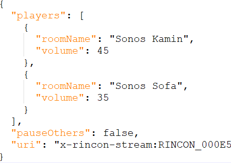

The fastest alternative I know is the node-sonos-http-api from Jishi. It is also available as a Docker container, but I have installed it natively on my Synolgy. It’s not without effort, but you’ll be rewarded with a higher performance and stability. You can also define presets, e.g. any groups with predefined volumes for each player that are activated with ONE http command. Not quite in real time, but almost.
Preset TV.json:
