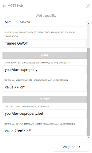

Just create an MQTT Device and add a ‘Turned On/Off’ capability pointing to the correct state & command topics of your tasmota device.
Then you have two options to solve your problem:
Either configure the input and output templates like this:
input: value == ‘on’
output: value ? ‘on’ : ‘off’
Or leave the input & output templates empty. After creating the device, go to the advanced device config and select ‘on/off’ for the ‘on/off values’ setting (true/false in screenshot), this will automatically convert boolean values to ‘on’ & ‘off’ in both directions.
