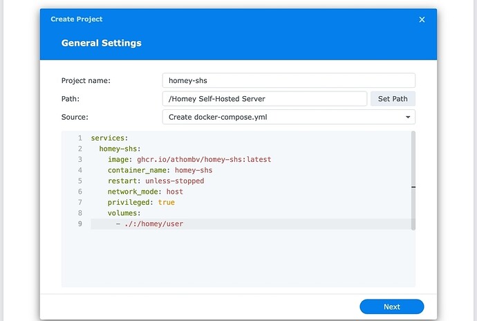

Synology container error
Why this error in container?

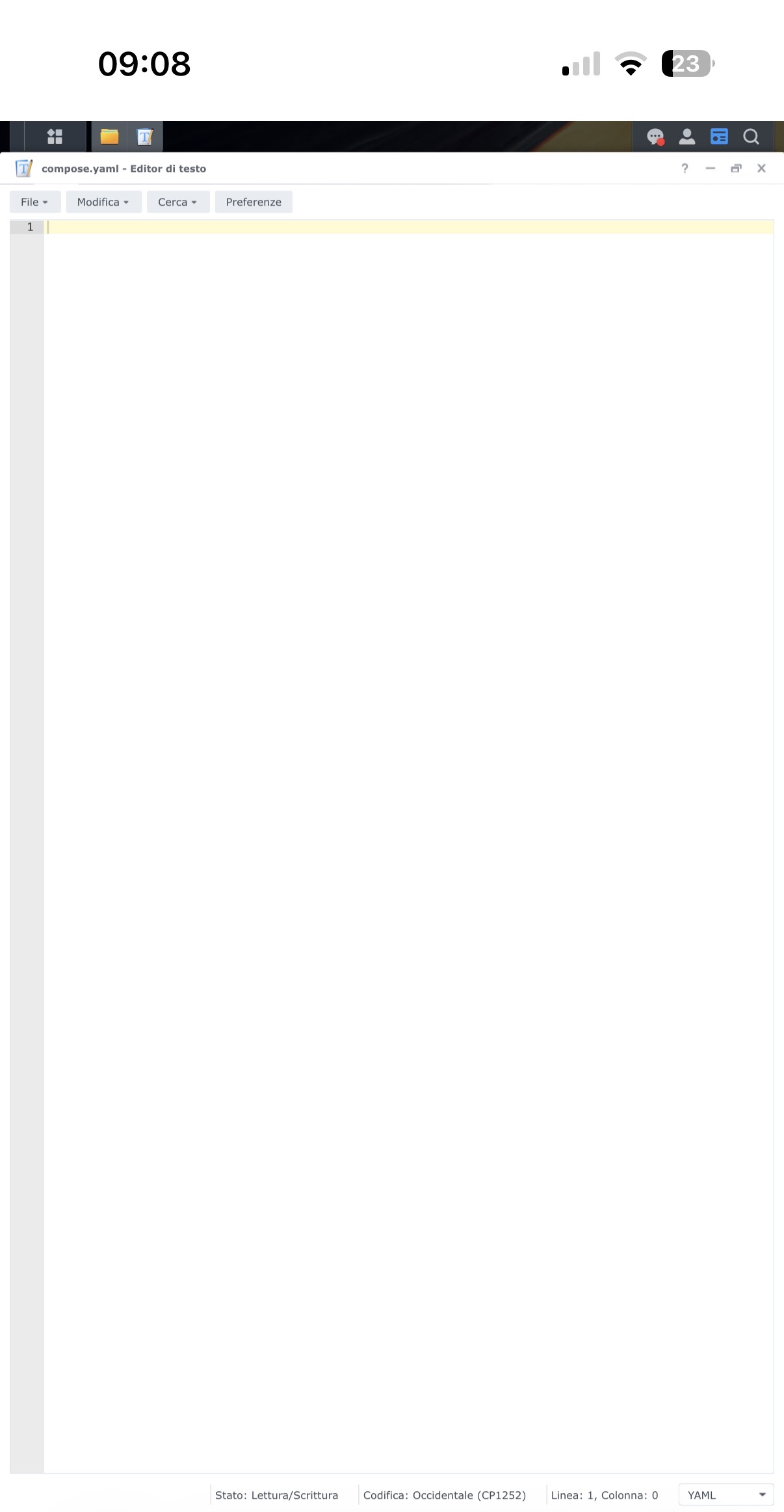

There is probably an error in your docker compose file. Can you share the contents of the compose.yml file?
It is empty

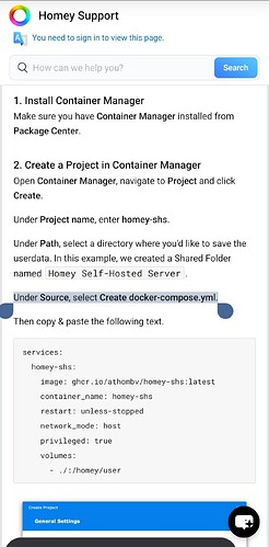

Why is it referring to compose.yaml?
Shouldn’t it be docker-compose.yml?
Fine manual

Lovely DSM inconsistency: all text refers to “docker-compose.yml”, but the actual file that it generates is called “compose.yaml” :man_shrugging:t3:

I finally solved it, basically I access Synology from iPad and to create the project on Docker it didn’t paste the right commands for the .yaml file, I modified it from the file manager with the text editor and it works
