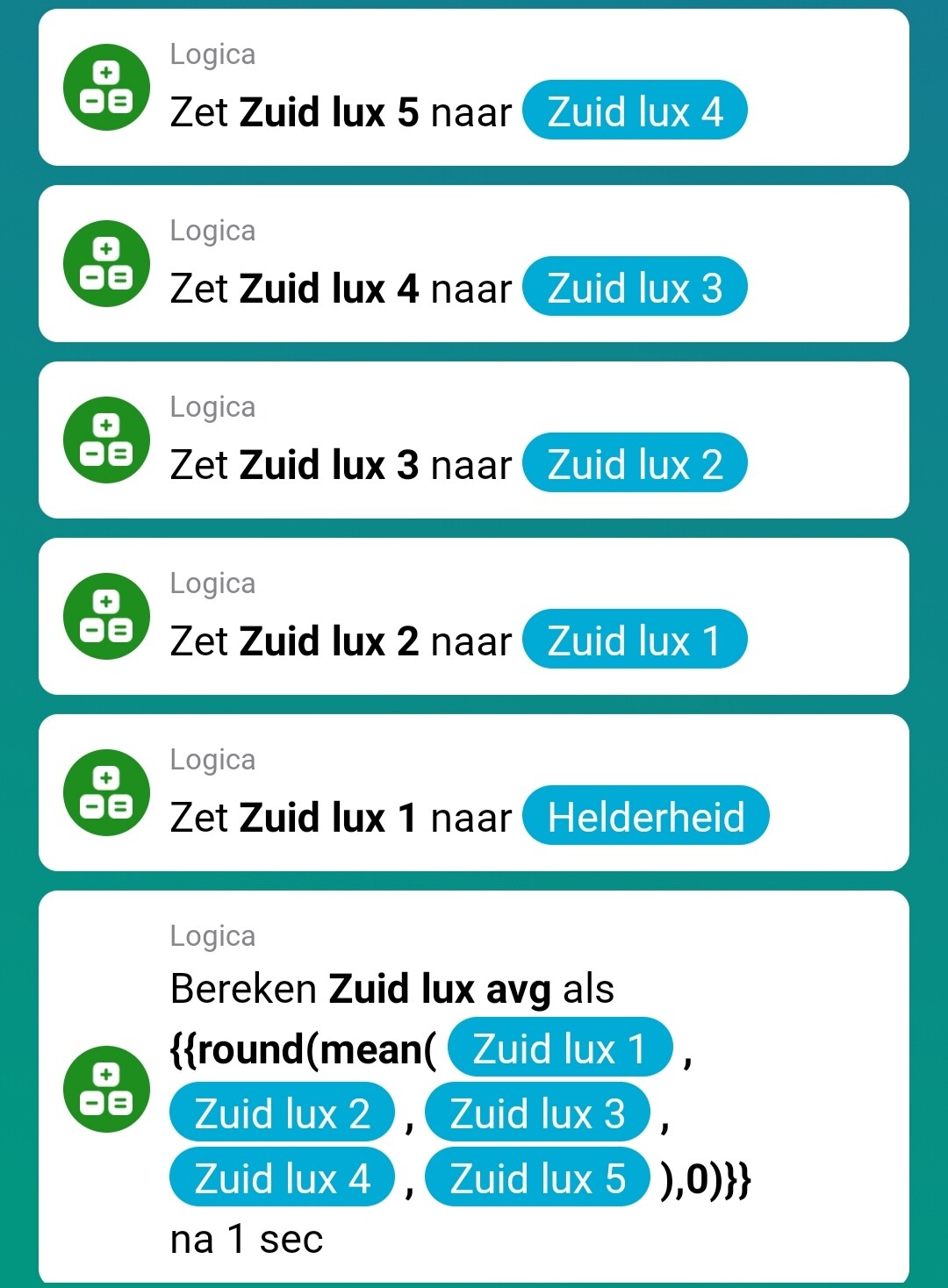

For this, I use a routine that flattens the curve:
https://homey.app/f/AZEmET
Rem: “buitenlicht.gem” is a numeric variable.
The second card is not functional for this routine (test variable).
I’m using a shift register to flatter the curve:
The flow is triggered each second minute. So the average lux is over the last 10 minutes.
