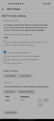

The broker needs to allow unsecure connections.
Only with these settings Borker allows you to save without error.

mqtt broker

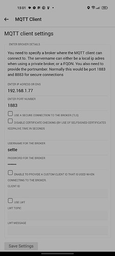

Mqtt Client , entered the ip of my Homey

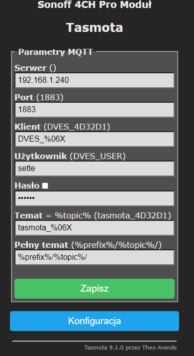

Why has the IP address changed from .240 to .77?
I thought that Homey’s IP should be entered there.:
homey ip: 192.168.1.77
ip sonoff: 192.168.1.240
Yes, the broker runs on Homey so you need to point Tasmota (and the MQTT Client) to Homey’s IP-address.
Not sure why it can’t connect. You can try enabling “Disable user authentication” in the broker (and blank the username/password settings on Tasmota) to see if the issue is related to that.
Wow, there is some progress after your suggestion, I changed the settings and I was able to go to the next step. Of course, it can’t be too good, because in the next stage after the sonoff restart, it doesn’t search for it:/ and that’s all in the sonoff app.

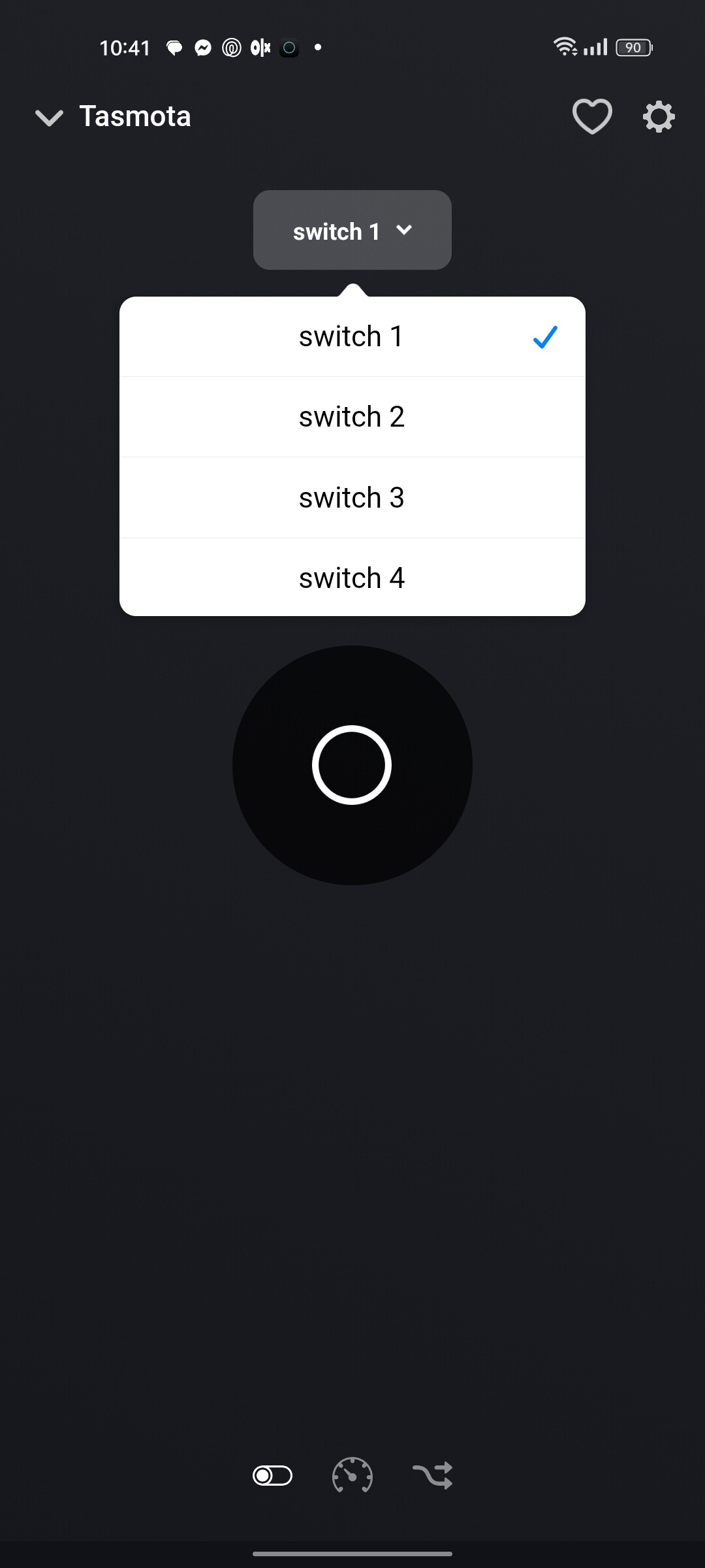

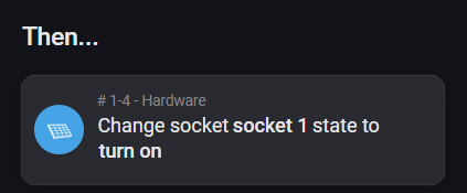

Hy, I just buy e HP2023. I configured Tasmota bridge & client apps and It seems to works. I have manu Sonoff tasmotized that are recognized. But I have a problem with a 4ch board. I can see a windows where I can select one by one the relays. I understood that I need something like Virtual device or Device Capabilities to separe output and address at flow level. Could you explain how I can do this ? I create a virtual switch, but when I try to associate a flow that drive the Sonoff 4ch when I try to associate a flow the menu don’t show me the choice of which output to use. Thank you in advance.
Actually, you don’t need a virtual device to control it. You can select the switch as Socket1-4, as you have already noticed. The prerequisite is that the Sonoff CH4 is connected to the power supply so that Homey can find the devices.
Thank you but the problem is that the peripheral is recognized with 4 relays but is address only at the main address name, then I can switch all at the same time. Is there a way to manually add devices to specify that is not a switch but a socket switch with 4 separate outputs?
Will you see a drop-down menu with 4 channels to choose from?
