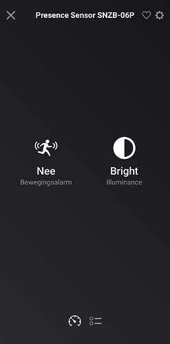

One question: I don’t see the presence indicator, only the motion detector and the luminance.
Is this feature available and how do I activate it?
Kind regards
Ivan
AFAIK the sensor only supports presence/occupancy. But since Homey doesn’t have specific support for this capability, it’s “translated” to motion/beweging.
In other words: if Bewegingsalarm is “Ja”, it means the sensor detected presence.
