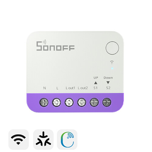

I received the “SONOFF Smart Roller Shutter Switch MINI-RBS” these days… and installed it today on one of my roller shutters. Integrating into my Homey Pro 2023 worked without any problem, but after connecting the cables and trying to move the Roller Shutter, I only got it to work to open or close the rollers completely. I was not able to open it to 10% or to 50%, it more worked like an On and Off switch. On = Closed and Off = Open.
I also had a look in the Advanced Settings, but there was not anything useful to configure?!
Does anyone know if I can configure this Matter device to work as it should?

Ok, Problem solved! ![]()
Just read the manual. I had to start the calibration.
Great. Now everything works as expected.![]()
