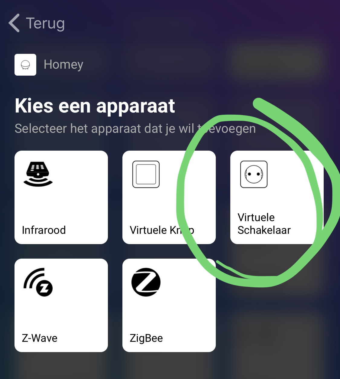

If you make a virtual device it shows in google home.
Connect a Flow to it and make it open and close your somfy.
Thanks for that. I also just saw that when I tried disconnecting and reconnecting homey to google home. The first time i did that i did not read a lot, as I was very excited about it. Have been waiting for it for years now.
@Michael should i then just use a on off device ?
You should choose the switch, not the button (i don’t have the exact translation)
