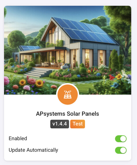

But the version installed, 1.4.4, is from the version you sent?
It should be. For certainty, here’s the link:
https://homey.app/en-nl/app/nl.dj.aps/APsystems-Solar-Panels/test/
