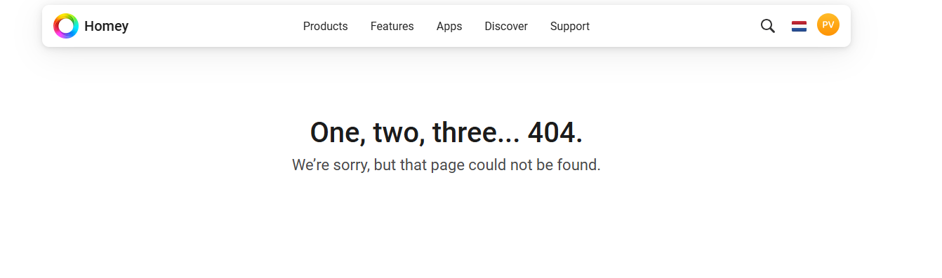

Device just became unavailable and the app no longer exists in the home app Store…. @Dick_J something happened?

Maybe I can help, it is really strange app was working and now for the second time it mentions application unavailable and when I got to the store link it is gone as well. When I click the old app link from this forum post I can install it again and it works again. Needed to do this now two times already.

Hi Niels, that happened to me as well, I turned automatic update off and than you don’t have any problems, you only have to update manually.
It seems that the automatic update installs the regular version all the time instead of the test version.
