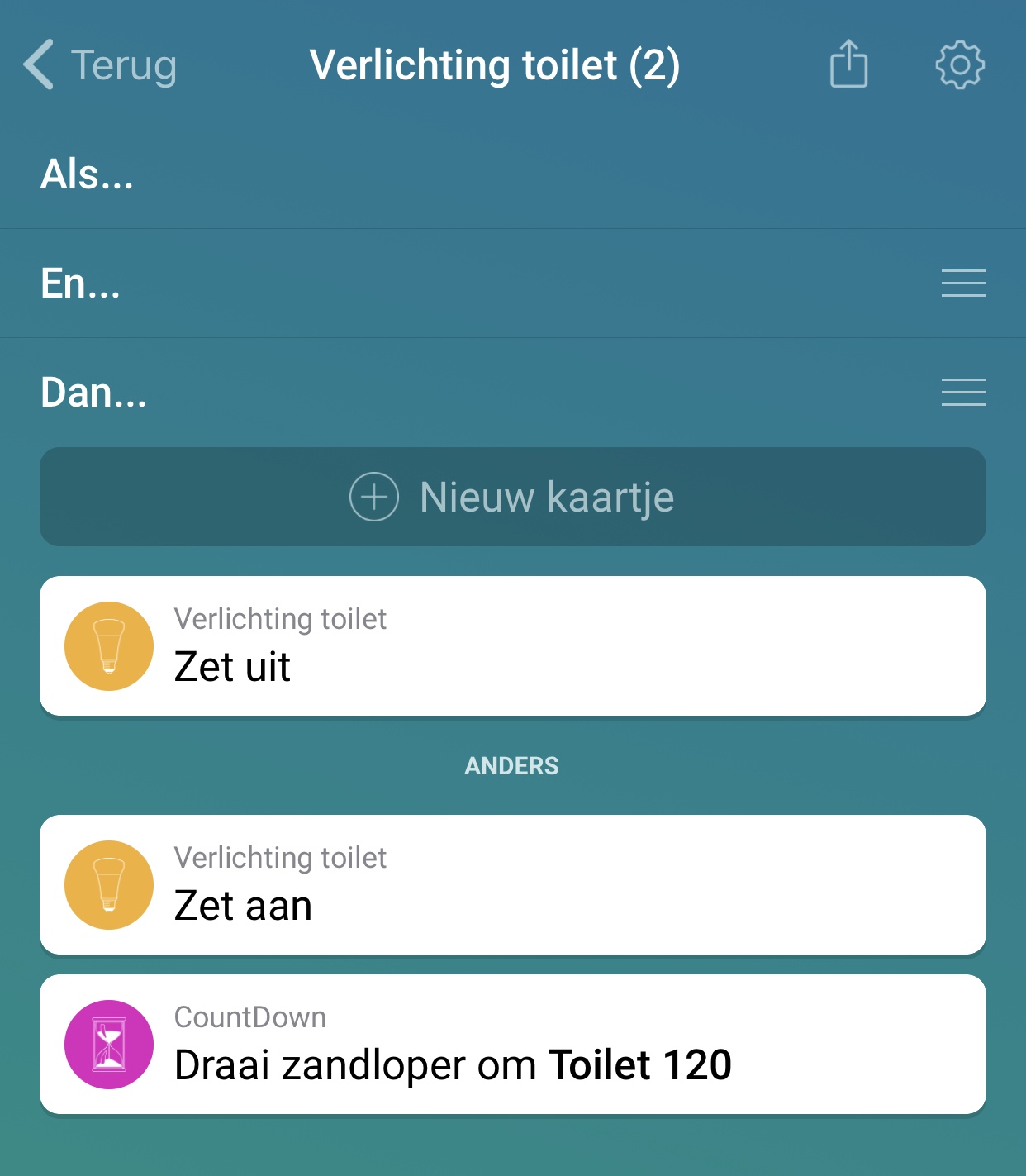

I use this flow for my lights in my house. It’s 2 flows instead of 3. Maybe it’s usefull for someone so i thought it’s nice to share.
It works perfect but if it is in any way incorrect, please tell me. :blush:
This is possible ofc. Only disavantage is that ur timer will be running as long as ur inside. The timer in the OP will only run when motion is stopped so will run way less then urs.
Why would you turn on the light when it is already on?
I noticed this flaw a few months ago and corrected it. But thanks.
I’ve tried to make the flows in TS. But when i want to create flow 2 of the tutorial, i dont see a option to “Start Countdown timer”.
I only see this:
Je kunt “ draai zandloper om” gebruiken. Wel eerst een timer aanmaken die je kunt omdraaien
Like Frank says: use “draai zandloper om”.
Thank you. I got the logic now. It got it working.
