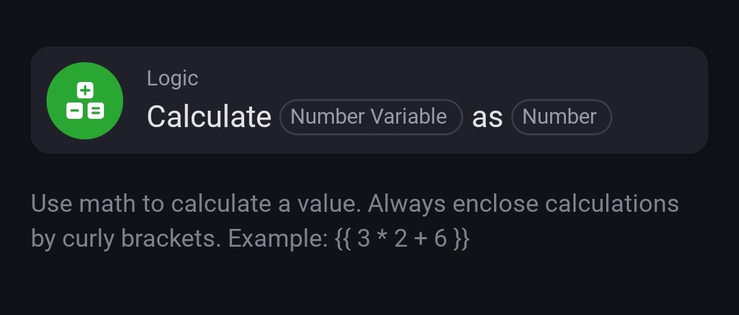

Contrast is a bit low and I was put off guard by the name of the logic card “Calculate (numeric variable) to text.”
Thanks so much for this thread as it’s exactly what I am trying to do.
However, I am stuck with the very first part. I can create and set a variable for the Dim level, but how can I read the existing value of the dim level variable from a lightbulb. I can see the value, and adjust it, but I cannot read it with logic function.
Seems to be a (translation) error @ Pro 2023.
The ‘text’ example text should read ‘number’.
I’d nudge support about this, to get it fixed.
Is this more clear, Mark?
Maybe the formula is seen as a text string?

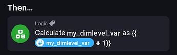

The first THEN card example visual:
Thanks for the quick reply Peter, unfortunately that didn’t help. Probably I’m not understanding the logic…
My smartbulb displays a variable named “Dim level” that states the level that the lightbulb is dimmed to.
When I follow this example and I create my own variable called “dim_level_var” I have to set an initial value, I cannot set it to equal the variable named “Dim level” attached to the bulb. This is what I believe I need to be able to do.

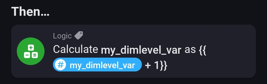

Therefore whenever I initiate the flow in this screenshot the calculation takes “dim_level_var” then adds 0.1. This means that the flow always outputs “dim_level_var” = 0.2. The var “dim_level_var” = 0.1 and then the flow adds 0.1. When I start the flow again it simply does the same thing.
YW, Mark
The lights should be driven by a separate flow, like
WHEN
variable ‘my_dimlevel_var’ is changed
THEN
Dim light to ‘my_dimlevel_var’ (during 5 seconds)
So deattach them from that flow, and start a new flow (on the same canvas), starting with this logic card
To get this result:
