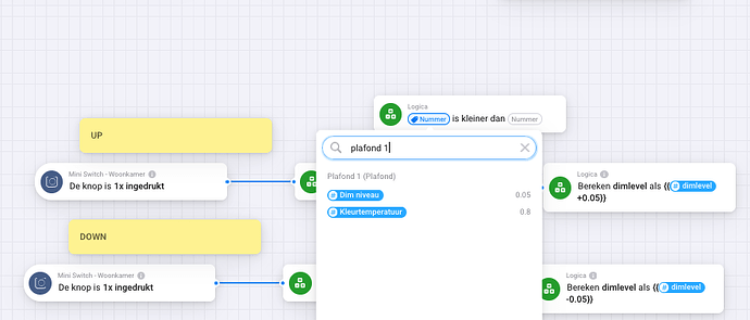

Hi, made this flow but doesn’t work. can you see what I do wrong?
When you make the number variable, what value must it have? I made one with value 0
I think you are using ‘dim niveau’ of a light itself.
You should be using the logic variable:
The bottom one is the one I have created
