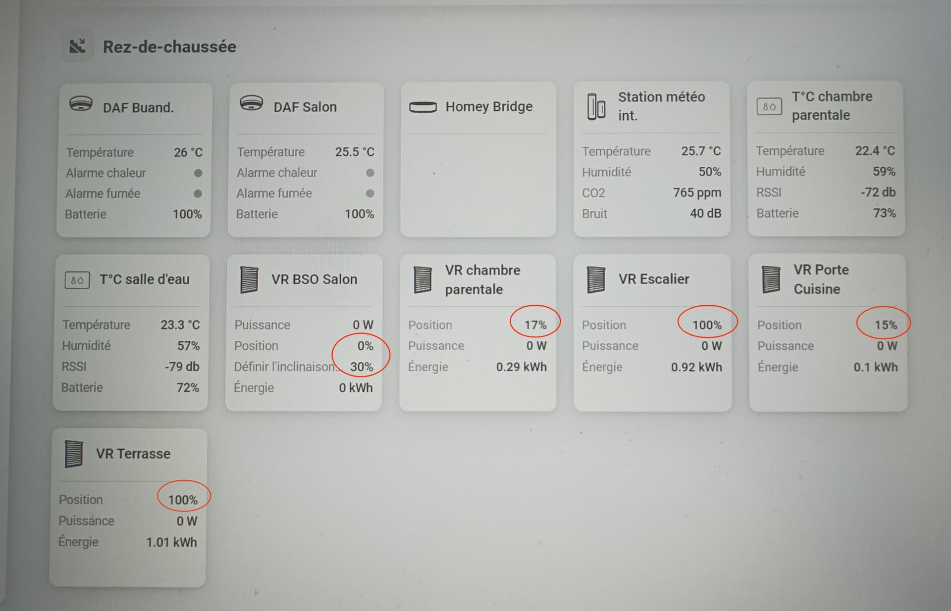

I have a question about the “devices” page of the Homey app.
Is there an option to see the opening status of all my roller shutters? It’s very inconvenient to have to click on each icon to know the status of the roller shutter.
However, the Google Home app does it very well. We see the entire installation at once:
Thanks !

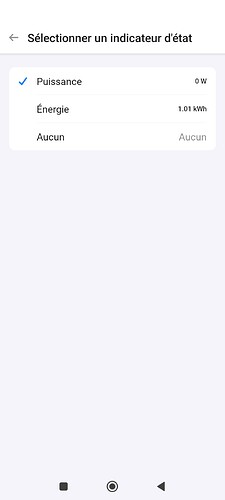

Unfortunately the app doesn’t give me this choice. I only have “power” or “energy”.
So I will call on the developers

@Peter_Kawa, from what app or device are these screenshots?
Of course I don’t know every devices and apps for shutters, blinds and similar devices. But this is the first time I see percentage status for those devices in the device tile. So maybe it’s an Advanced Virtual Device?

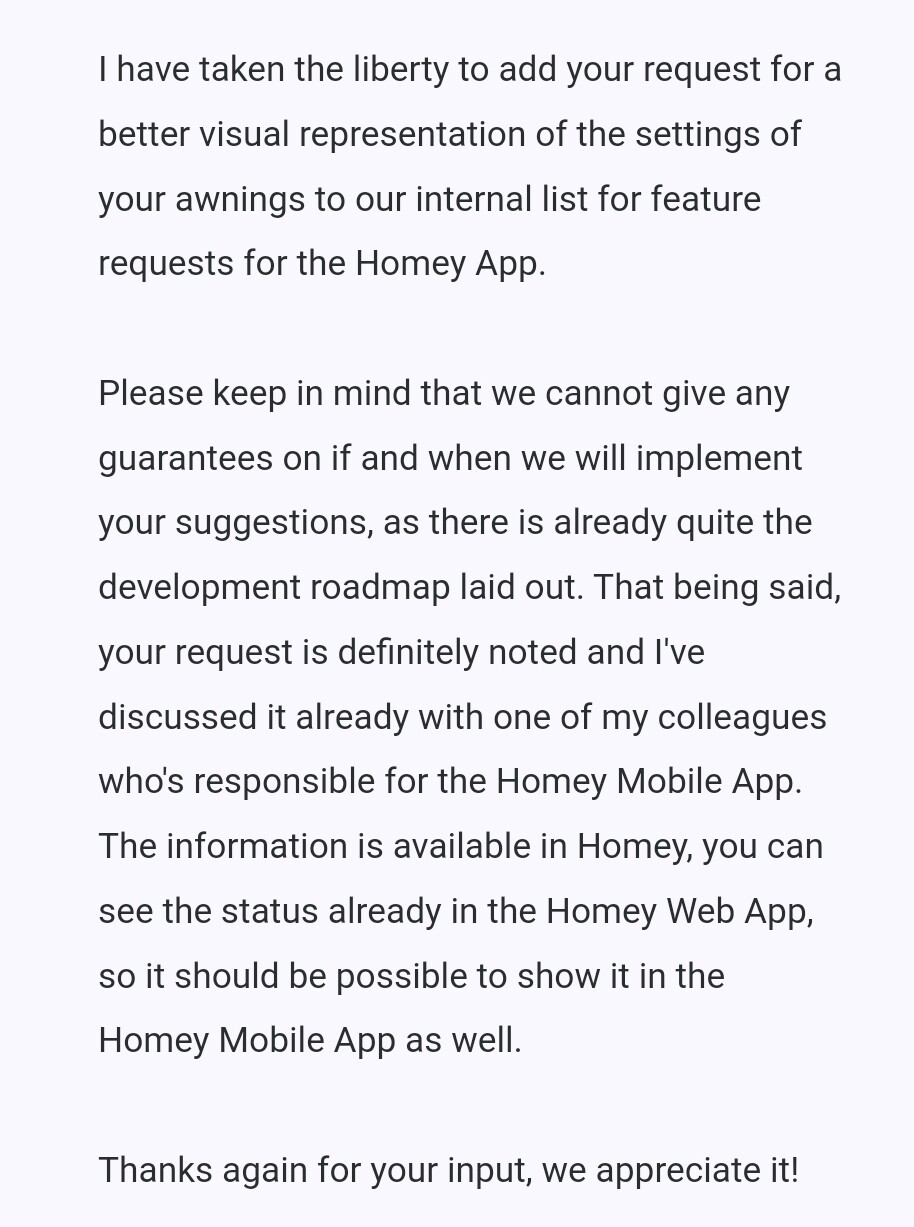

I contacted support and this was their answer :

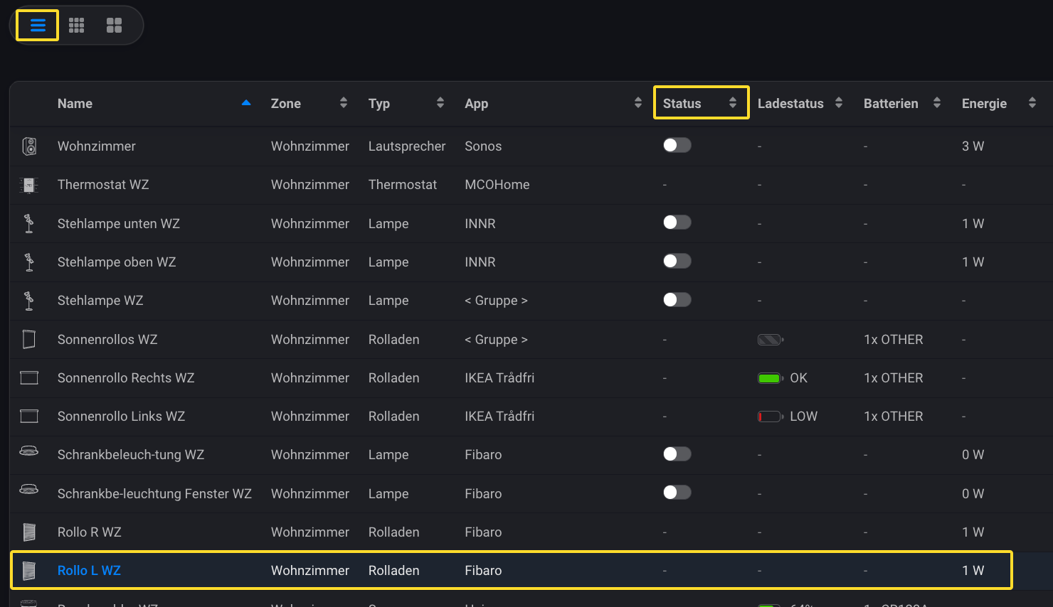

Have you checked already if it’s possible in the WebApp?
In my case, I use Fibaro Walli Roller Shutter, it’s not possible:
Even if the information of the status (windowcoverings_set) is of course available:
(For info: 1 means 100 % / 0 means 0 %)
What I don’t know is if the device needs to be removed first and then re-added for this new feature (?) to become available.
On the web application, one can see all the positions on the global page.

Btw, the position is also not shown in the list view.
No, I can’t select the positioning on the web app. I can only select Power or Energy.
Here is the support response:

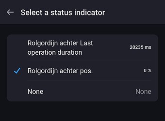

Not relevant anymore, but I just to clarify:
It’s a ‘home assistant community app’ cover entity from a Tuya curtain motor.
