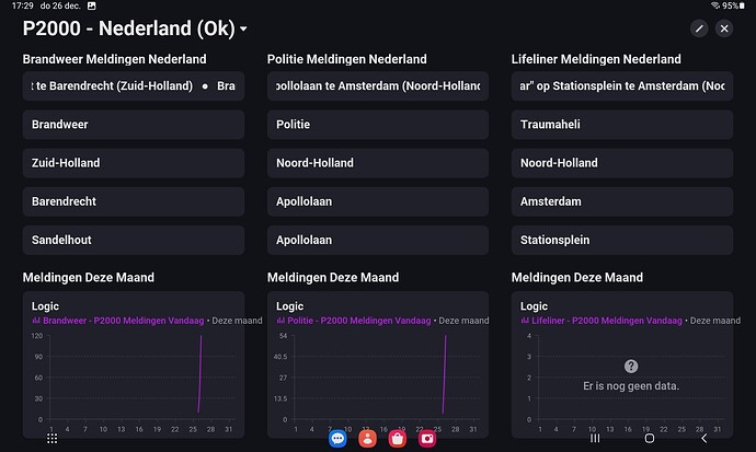

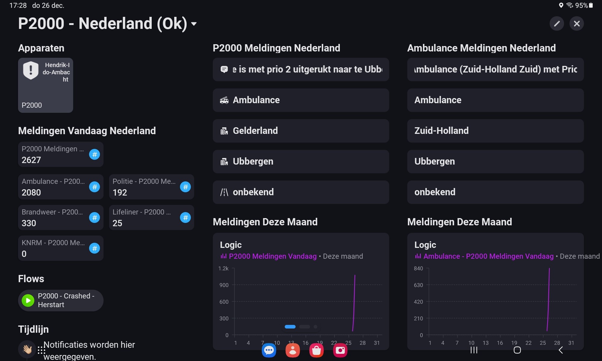

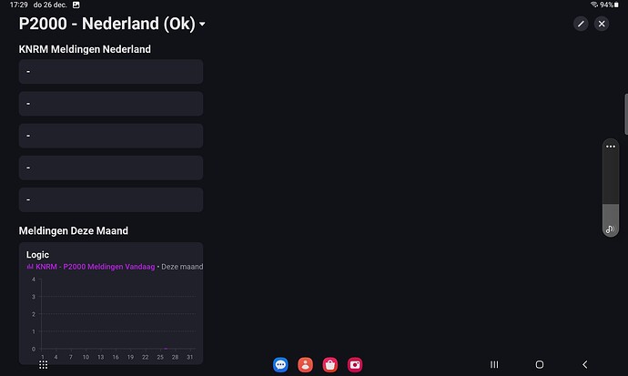

Here’s my P2000 Dashboard
Very nice. Works great.

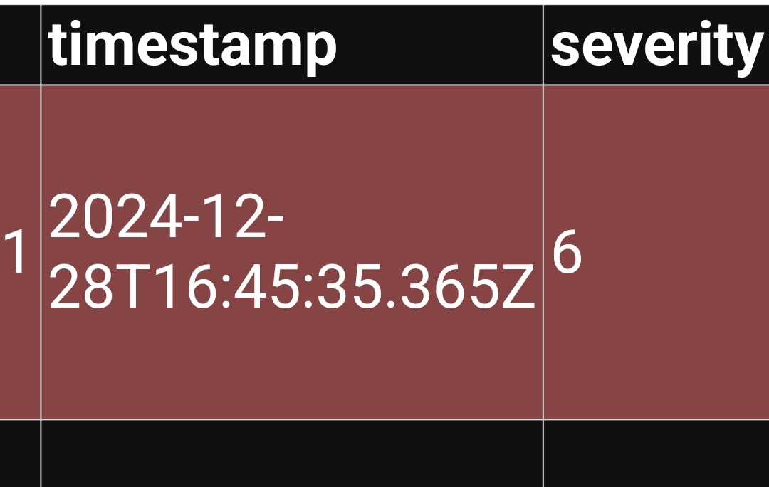

The only problem I have, is that the timestamp is one hour behind
When I look into the simpleLog-app, it shows e.g. 9:00, which is correct. In the widget it shows 10:00.

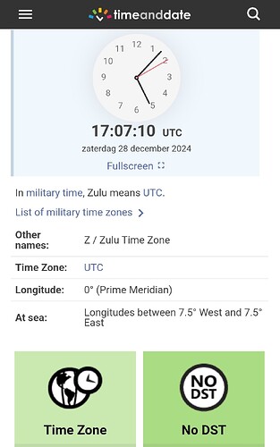

The html page shows ‘zulu’ or UTC timestamps, recognisable through the trailing Z, like
2024-12-28T16:45:35.365Z
The timestamps in the app settings logs are showing local time.
Why the difference?
Some time ago Athom decided to have Homey’s ‘internal’ clock running UTC time, causing situations exactly like this.
Many developers and script users “don’t appreciate that decision”.
The app developer created a conversion to have the app logs show local time timestamps.
The HTML page fetches the logs with their original timestamps, which are UTC time
I think many log applications use UTC timestamps, just to eliminate possible time calculation errors.

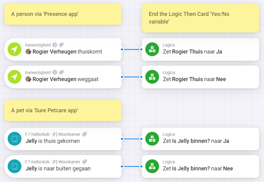

Hi Martijn,
Could you tell me how you got the part underneath the digital clock (That someone is outside with the checkmark?)
Dat is een ja nee variabele, aangepast door een flow.
Hi Jeroen,
A bit more info for you.
Great! Thank you Rogier!
