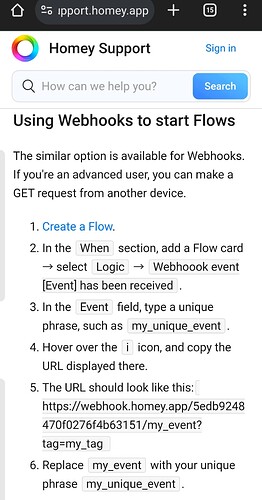

In Vera, I use the luup.inet.wget function to send HTTP requests when certain triggers occur. For example:
luup.inet.wget(“http://192.168.xxxxxx/blahblahblah…”)
This allows me to trigger actions or scenes remotely. Do I understand correctly that webhooks in Homey would be able to receive these requests as commands or triggers, and execute certain actions or rules? If so, does anyone have experience or insights into this type of integration with Homey?
I appreciate the suggestion to create my own app for Homey if my device isn’t supported. However, after watching a YouTube video on creating apps for Homey, I’ve come to the realization that I’m nowhere familiar enough with JavaScript, let alone Java for Homey.
While I know there are online resources available for learning JavaScript, my extra concern would be understanding Homey’s communication rules and protocol. I suspect there’s a learning curve involved in that too, and I may not be ready to tackle it just yet… but thank you for your suggestion
Claude
Short answer: yes, you understand correctly.
Webhooks aren’t rocket science. I would suggest you look on the forum for examples and ask advice if you need any.
Just fyi, Claude.
https://support.homey.app/
This example uses the Athom cloud, when you want to use local webhooks, use this format
