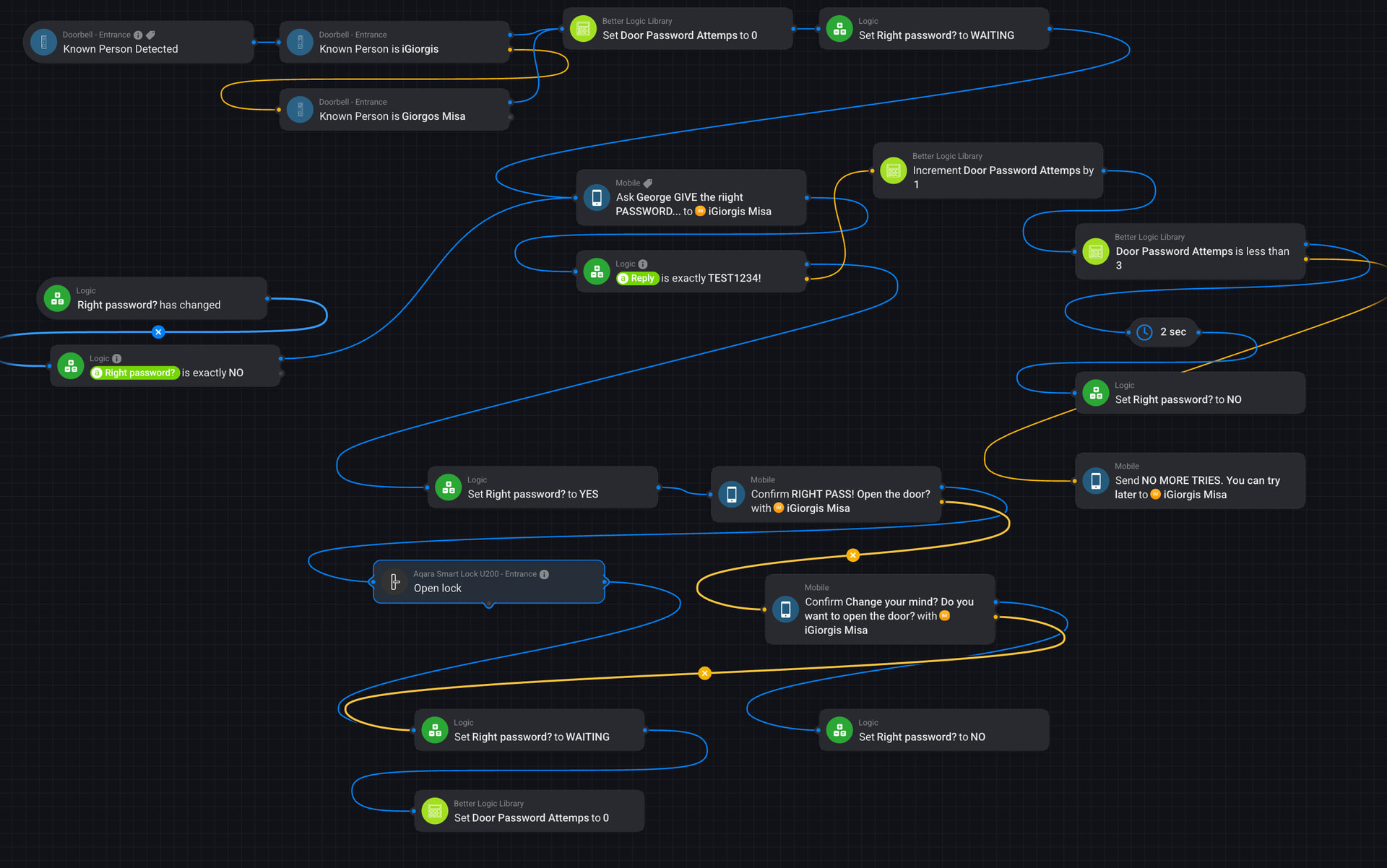

I just created a new Advanced Flow using the new Mobile “ASK” card and wanted to share it with the community. The idea was to build a small secure door access system using face recognition together with a password verification before unlocking the door.
The flow is triggered when the doorbell detects a known person, then the system asks for a password through the ASK card. If the password is correct, it asks for confirmation and unlocks the door. If it’s wrong, the user can retry up to three times before the system stops.
Features:
:white_check_mark: Face recognition
:white_check_mark: Password authentication
:white_check_mark: Retry system
:white_check_mark: Max attempts protection
:white_check_mark: Reset logic for the next attempt
:white_check_mark: Confirmation before opening the door
The flow uses Better Logic Library to count password attempts and prevent unlimited retries. When the maximum attempts are reached, a notification is sent and the process stops.
I’m sharing this in case it helps someone experimenting with the new ASK card and Advanced Flows. Feedback or improvements are always welcome!
Thanks! :slightly_smiling_face:
Flow overview:
