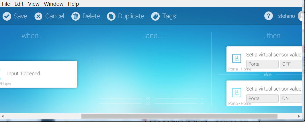

I added a virtual device Class “Home alarm” of the many capabilities
only the one with
How do I use this device?
I mean the switch will always be open as if there was motion detection when the window is open
If I also select Capability ON/OFF it does not have meaning to Heimdall, since all sensors are seen as motion sensors, therefore I canNOT be acknowledged if a door is open or close:
and finally how should the flow work to say to Heimdall the status is changed?
The flow card to set the state of a Virtual Motion sensor isn’t functioning in version 0.7.3 of the Virtual Devices app, it is fixed in version 0.7.4 but that one has not been released to the app store yet.
