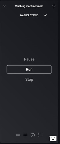

In theory you should be able to start it with the Washer Stats option:
The washing machine has to be switched on and the remote control has to be enabled. But then you can leave it in the Pause state and start it when required by changing it to the Run state.
Edit: I have just noticed there is no Action card for that so I will add one in the next update.

I have updated the SmartThings app in the HCS. It should now support setting the washer status via a flow, plus the other washer capabilities.
Wauw that’s fast!
I saw the option to start it when remote control was enebled though it never seemed to respond to it. Your update fixed it! Works like a charm :heart_eyes:
