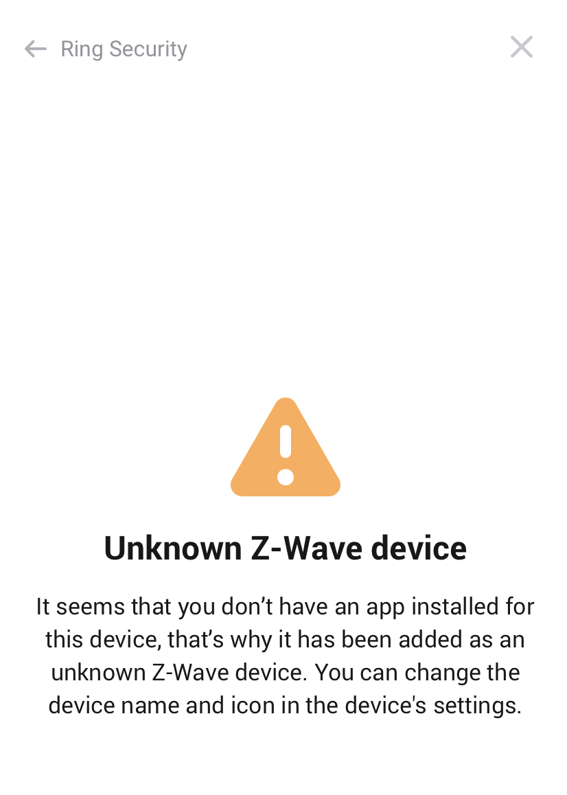

Thanks to @Carlos_Kronemberger and @Dudley_Rodriguez for providing the information on the Ring Keypad V1!
You’re the one who helped me! I also have with me a v1 contact sensor and a V1 motion detector, both Ring US/CA. Can I send the codes for you to implement?
Sure, please do!

New version published
Version: 0.2.17
- Added US/CA device ID to Ring Contact Sensor V1
- Added US/CA device ID to Ring Motion Sensor V1
Thanks @Carlos_Kronemberger!
