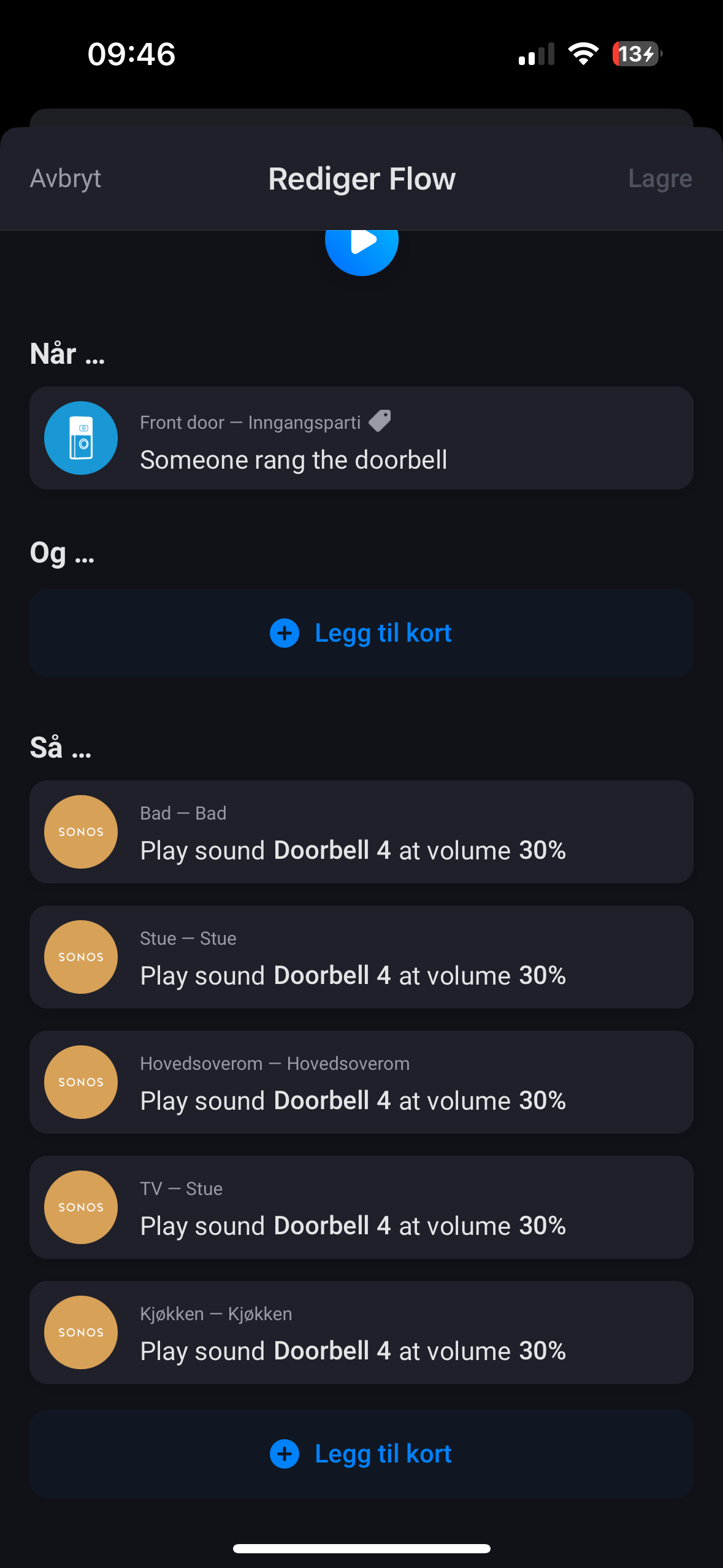

Dear forum users,
I struggle severly with my Ring Video Doorbell which does not generate any alerts in my home.
I have a Homey Flow to send a doorbell sound #4 with 30% volume to four Sonos speakers, and when clicking “Play” while testing the Flow, everything works perfect. But when clicking on the actual door ring button, nothing happens via Homey, I only get a notification in the standalone iPhone Ring app.
How can I make my Ring app in Homey actually make a notification? I have tried removing both the Ring device and the whole Ring app from Homey, to no change. I also use 2FA on my acount. All help is greatly appreciated!
If you set the if card to trigger at general alarm that should do the trick.
I don’t see that option.
Here is my flow.
Which app did you install?
I think you’ve installed Athom’s version, I don’t recognize the flowcards. It should be able to do the trick but Emile told me it’s more limited than my version and the code isn’t open sourced so there’s no one to help you out with that app other than Athom themselves.
