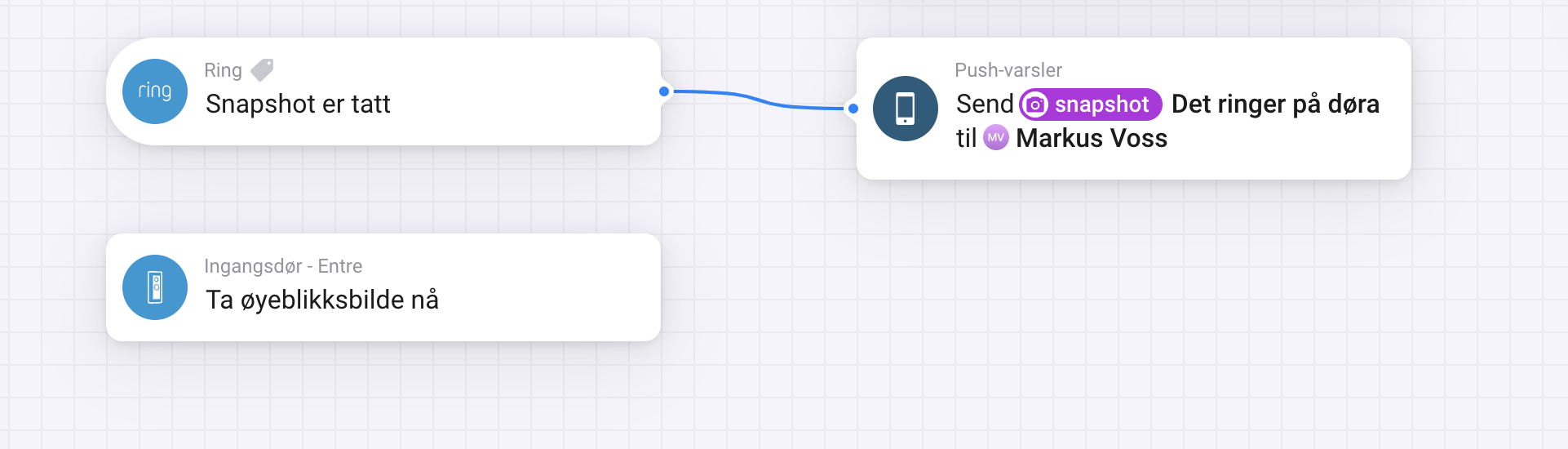

thanks for a great app. I have a ring doorbell. I just subscsribed to ring protect and tried to get the snabshot feature to work. I try to send the grabbed snapshot to myself as a push message. But there is no image. I have this in an advanved flow:

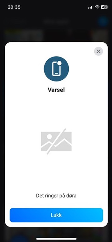

and run the “Grab snapshot card manually”. After a second I get a push message but no image. When I click the notification the app opens and looks like this:
I have enabled grabbing snapshots in the ring app for this doorbell. I am on a Homey Pro 2019 and have version 2.11.0 of the Ring app. PS: I have also tried to run grab a snapshot when the doorbell is actually rung, but no snapshot then either

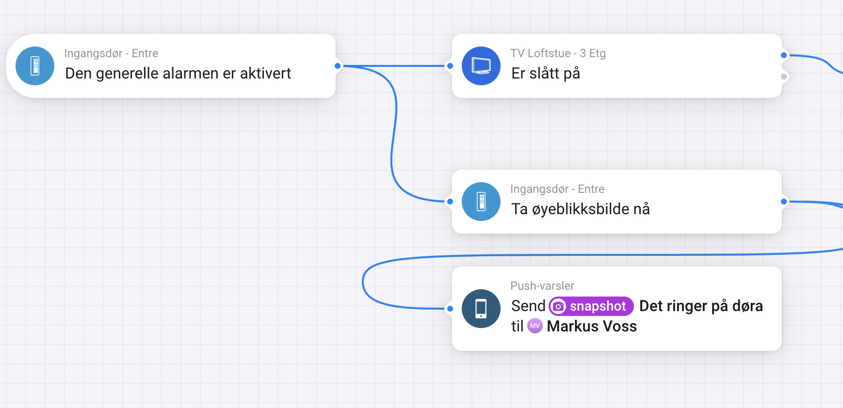

This is the flow I use and it works fine.
so strange. The same flow does not work for me:
What type of Ring Doorbell do you have? (Not all Doorbells are capable of getting a snapshot when there is a recording active)
It’s best to use 2 flows, one that send the command to grab a snapshot when the Doorbell is rang and another one that has the Snapshot is grabbed card as a trigger and do the actual sending of the snapshot. That’s the best way to prevent timing issues.

Ok so my problem was that I did not have motion detection enabled. Once I enabled motion detected the snapshots work. Thanks for all the help and a a great app @DaneedeKruyff !
