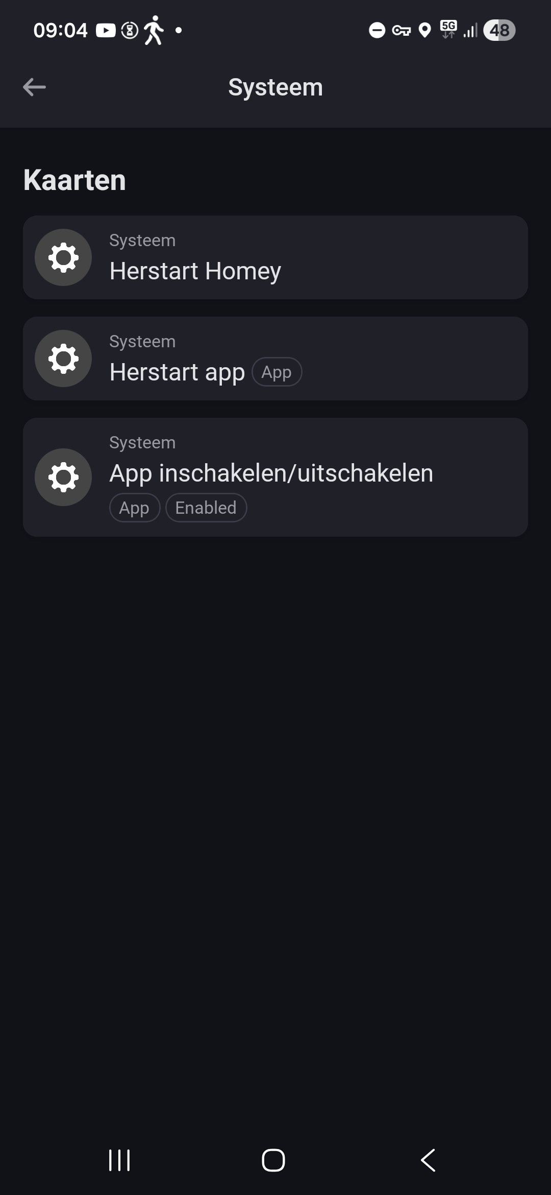

Thanks for your reply, under system i only have reboot homey and send pronto hex:
That’s strange. Do you have the Power User experiment enabled? It does have that option in my Homey:
On a Homey Pro 2023 and newer the restart app-card is located in the Apps section of the THEN cards:
Thanks @SunBeech , this was it!
