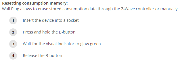

The only possibility It is possible to reset the energy meter value according to the manual is by using the B button. Don’t know if it’s possible via homey script or raw configuration.

I have to correct my last statement. According to the user manual, it is possible to delete the consumption via a Z-Wave controller.
However, it is still not possible to delete the consumption via flow, because this feature has still not been added to the Fibaro App.
Therefore, contact the app developer of the Fibaro app (Athom) and ask the developer to add this feature.
