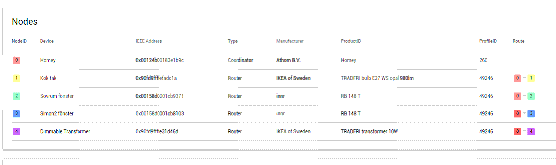

  1. Zigbee network.
    I have one Innr bulb that is 9 metres from Homey. This turns out to be too far away, 5-7 metres is maximum direct range.
    I have put one Ikea Trådlös LED driver closer to Homey, and it works as a bridge according to the Route table, and sometimes also works in real life but just as often Homey fails to control to the Innr bulb.
    See images: Innr bulb in red, bridge in green, and Zigbee nodes and routes from the “developer” page.

Both zigbee and zwave are mesh networks meaning device talk to each other so range will be extended by additional devices.
That said I have wooden walls and most device talk directly to homey or via one hop and I’d say my range is 20+ meters.
Zigbee is using the same band as 2Ghz wifi so that might cause interference I guess.
I also had a faulty z-wave node once which caused interference for other z wave devices.
In developer view you can see network topology as well as error rate (for z-wave).
And some devices also feature a range tester.

Well, if you range is just 3 meters I’d contact support, sounds like there is something wrong.
Theoretical range of z-wave is 100 meter but thats very theoretical, but still 3 meter sounds very short (even if you have tinfoil wall paper)…
I even have a working zigbee door sensor inside my 1mm thick steel mailbox some 5-10 meters outside my house…

Got a tips from Athome to go to http://developer.athom.com/tools/zwave and click on Heal on each device to force Homey to reconnct to the devices. That seemed to help.
