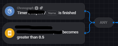

No ALL block after multiple triggers
Triggers probably never trigger at the exact same moment
Use an ANY block instead, or just connect both cards to the next one (ANY is fully optional).

Which card are you using with that yellow icon (directly beneath the “timer is finished” card)?
