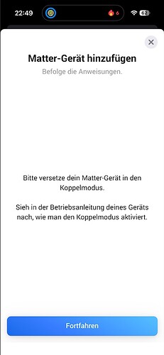

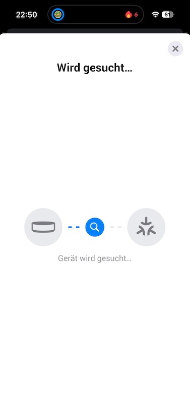

This is still so simple, as I do not get any error message. The setup process just gets stuck at the device search stage. (See image)
Here is the procedure for the setup. Unfortunately, I only have the images in German.

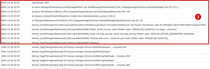

The only log I found is this one from the container.
Here it starts at point 1, then it gets stuck in the loop at point 2, and when I cancel it in the Homey app, the entries from point 3 appear.
It’s clearly going wrong at some point. It’s weird nothing gets reported in the GUI screen;
