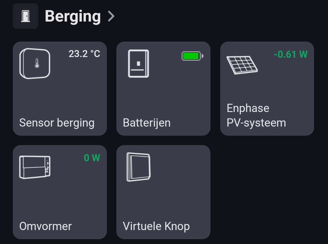

  1. The device gives at night often a negative value, while the device of the Enphase inverter app gives 0.
  1. Sometimes the device is unavailable. Any idea what can cause that?

Thats weird. I’m just showing what the Envoy is reporting. But it might be a good idea to clamp this value to 0 indeed.

Without sunlight, the inverters and the IQ gateway are in a sort of standby mode and consume a small amount of energy: approximately 10 watts (the number of inverters affects this value).
Rrrrrrrrrrrrright… @Timelezz must have the Metered gateway that’s measuring the actual production/usage. With me --having unmetered-- it’s just showing what the gateway itself is reporting: 0 at night.
But like i said, i’ll clamp it a minimum of 0 to prevent unwanted readouts.
