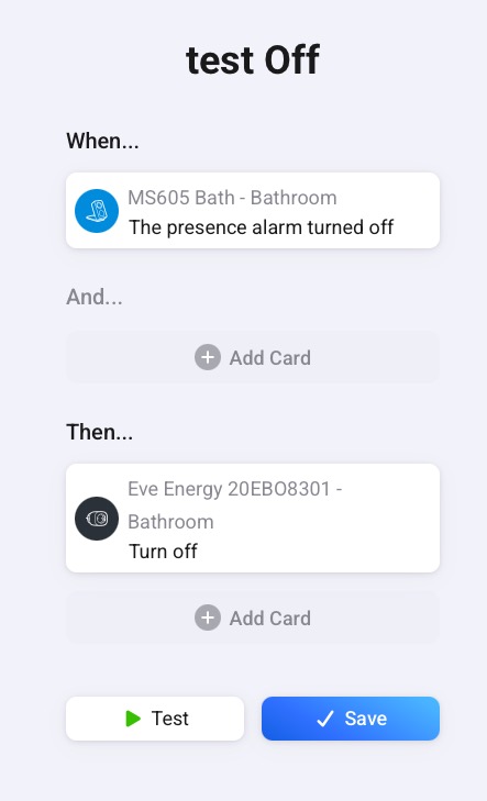

I did two flows. It works perfectly. But I have a problem after midnight the plug or lights turn on out of the active time from sunset to 23.30 hour. How can I do this right so plug does not go on after midnight? Thank you!
