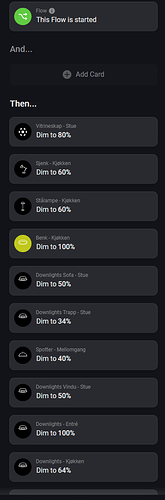

So this is how my “God morning”-scene looks:
As you see, there’s a lot of “zones”. The lamps are z-grouped IKEA Trådfri bulbs, where three bulbs in one lamp is tied together as a simple “lamp”.
