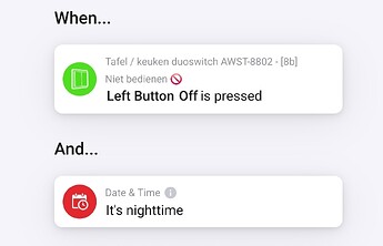

I installed de Philips Hue Motion sensor. I make a little automation in Homey, when it dedect motion, then the Zigbee socket go on for 10 seconds. This works great. But by day light , it turns also the Zigbee socket on. Does anyone know how to turn the Zigbee socket only in the evening / night when it’s dark, when the Philips Motion dedect motion?
You could add the inverted “and it is daytime” card as condition.
This only allows the flow to continue during sunset to sunrise:
The hue motion sensor also measurues lux, so you can use that as an additional AND card
AND (logic card) lux < 5 (or another value)

Yes, I modified my flow with a sunset rule, the lighting problem in daylight is now solved. Thank you Peter.
Hek verlichting overdag uit
I will try also try the lux possibility in logic card. Just to try out. Thank you FKey.
