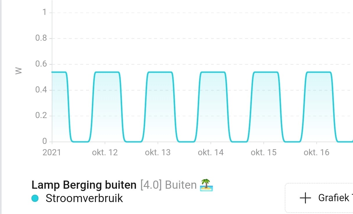

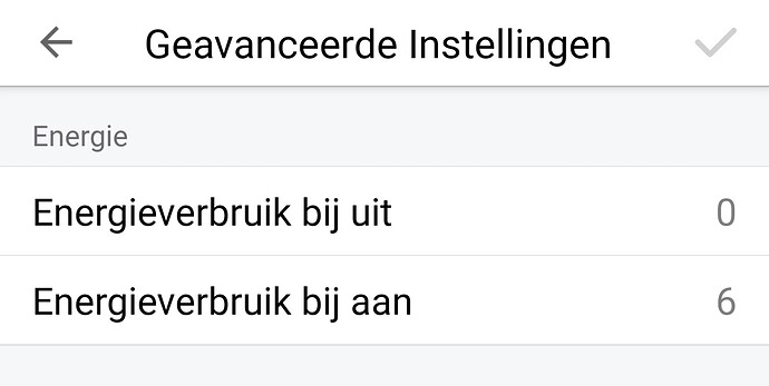

A workaround: if you entered different energy levels for your on/off devices,
your desired data is available in Insights.
While using an insights export app, you can create your logfile
