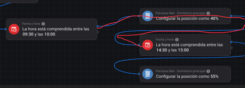

The doubt I have now is that yesterday I programmed this flow, and this morning it didn’t run (today is Saturday). I’m attaching a screenshot, sorry, it’s in Spanish. I think the problem might be that the “day of the week” card doesn’t actually shift the wake-up time 30 minutes later; I’m not sure if that’s correct.

Your problem is with the “ALL” card.
be aware: a “ALL” card wil only check conditions within the same trigger! It is not “Waiting” for a next trigger.
So in your case the input of the “ALL” will be checked based on every single 10min trigger. The 30min delay will just result in the check being done 30 min later, but with the same input.
You have connections to the “ALL” from both “true” and “false” On the “lenes y viernes” card.
So that will never happen. (Both “true” is impossimble

Okay, I get the mistake! If I change it to ANY , would that be correct, or is it better to add other cards for the “ELSE”?
Changing it to ANY does not make sense
In summer it will always run every 10min because of the “Verano” check
In winter it will always run every 10 minutes during the week (between lu es y viernes”) immediately in the weekend with a 30 min delay….
Also this part will never run
It will never be between 09:30 and 10:00 AND between 14:30 and 15:00 in the same trigger.
A flow will completely run on every trigger. So in your case every 10 minutes.
In this case between 09:30 and 10:00 it will flow until it hits the 14:30 card and end there. After 10:00 and before 09:30 it will stop at the 1st check.
What is your exact goal?
It is something about closing blinds in summer …:wink:.
But I cannot figure out what
