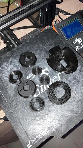

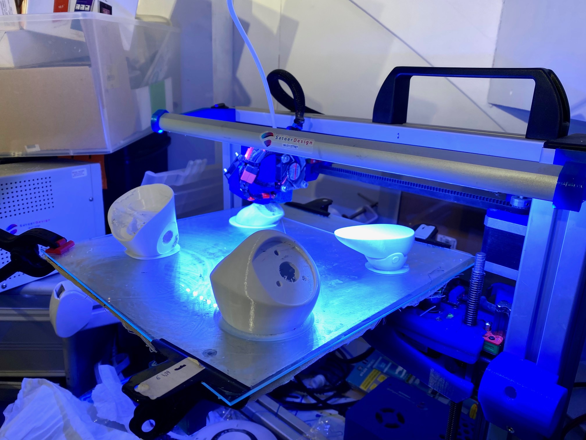

Printed everything with 0,1mm layer height with PET-G filament. Only the UpperArm needs support (I could not find a way to print without support). I printed everything else without support in the orientation of the STL model. You might want to add an attached Skirt/Brim to the feet (print upside-down).
Some overhangs are quite steep like the collar. But they came out great without support if you print a fine resolution (0,1 mm layer height) and use inside perimeter first. (Or inside out).
Try to print every part separate to overcome ugly travel blobs.

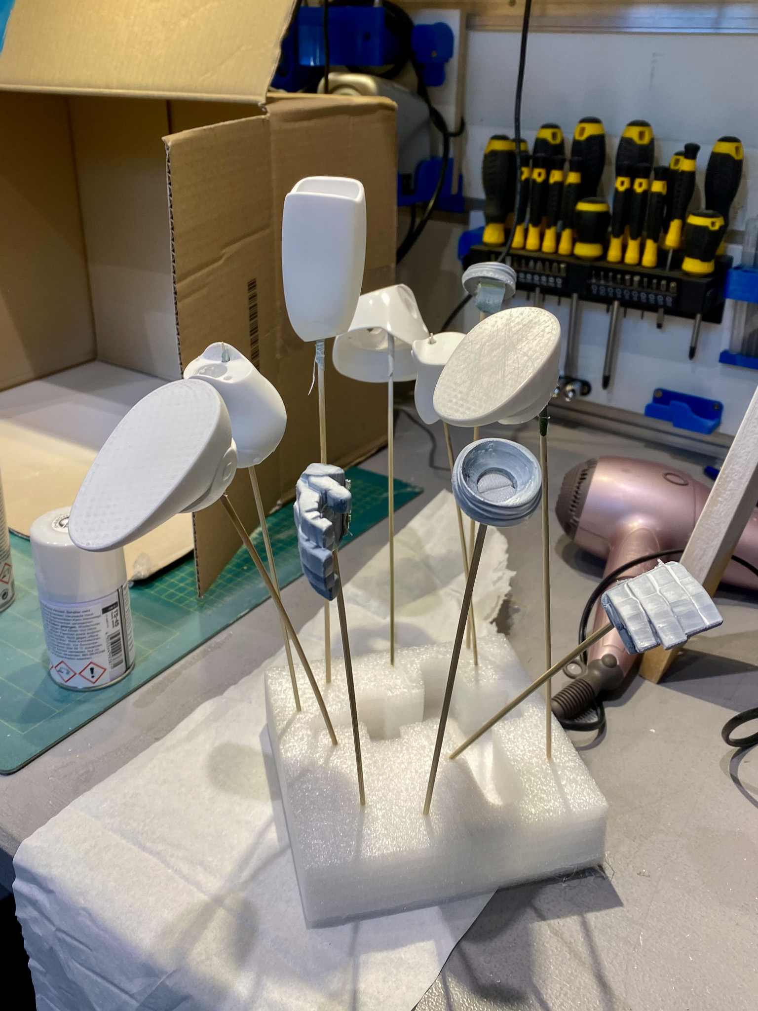

Sanded it with 80,120,200 and 1000 grid.
Used Tamya Surface Primer L White SP RS 180ml to prime
Used Tamya TS-45 Pearl white gloss 100ml for white parts
Used Tamya TS-82 Rubber Black mat 100ml for black parts

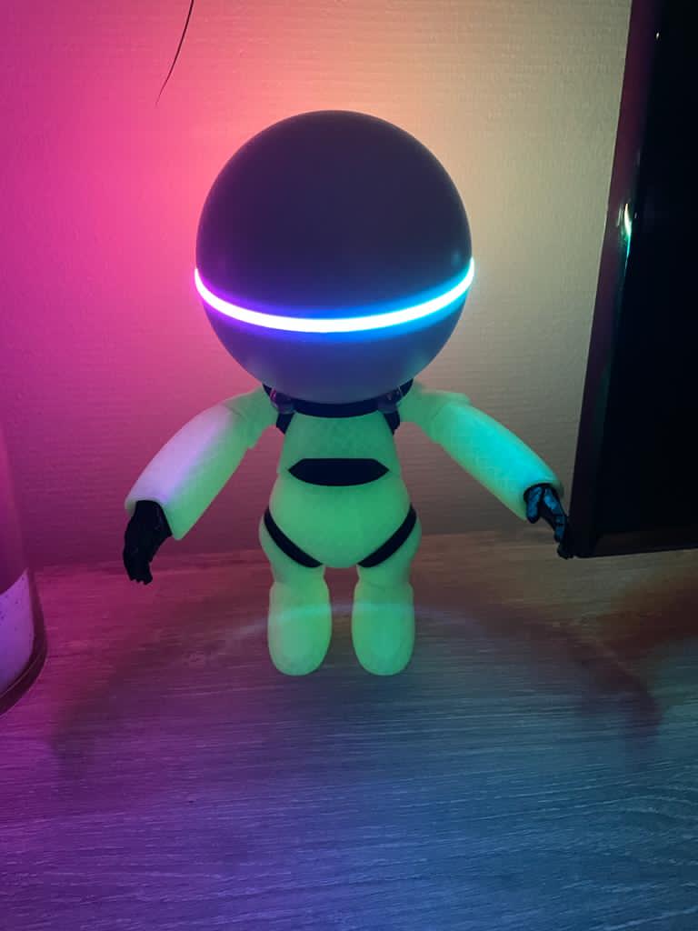

Making it black with glow in the dark
Ohhh definitely show us the result! (in the dark)
