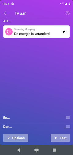

These flow works , only it gives the change of watt once a minute, not directly.
So it reports the change of watt, or am i wrong ?
Yes, of course it does, it is a value that is reported. But the trigger is the report interval, not the amount changed. At least, not for the watts.
I realize my statement can be confusing, so i adjusted it to make it more clear.
I will post an overview of the parameters of both versions later tonight.
When i try it with a lamp in the powerplug, with more watt instead of the tv reciever it for sure works, with the same flow.
So the change of watt can used as a trigger.
Obviously. Are you sure that is instantly and not because of the interval reporting?

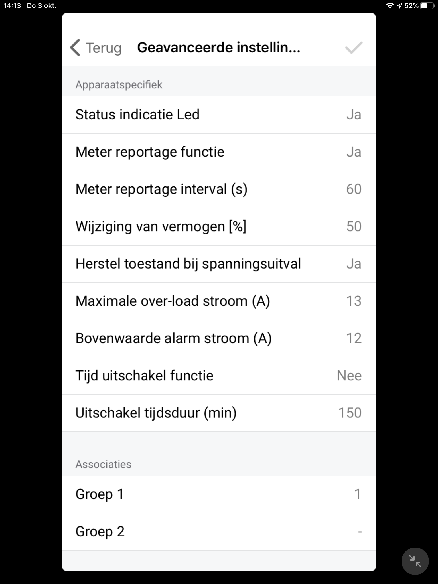

Sidenote: I went into the advanced settings just now and changed:
Meter report intervall: 60 sec
Power change (%): 5%
Anything else is default.
Works now, but its locked to report each 5 minutes. No matter the value change of the plug. The old one i could set to 60 seconds in adv settings.
Also did that to V2 plug but still reports at 5 min.
