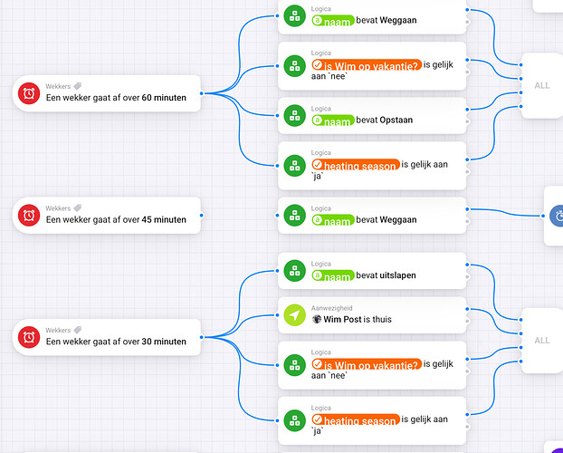

But if you know the Event, like:
or with Alarms:
It is already implemented…
And if you want 1 Check and action 15 minutes before the event, and don’t want to have multiple Actions Delayed with 16 minutes , just make another flow for them and:

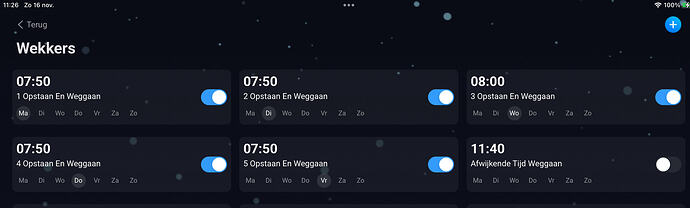

I have an alarm for every workday. I set the alarmtime to the time I want to leave home for work. One hour before the alarm goes off the heating is started and a wake-up light is dimming from 0 to 100% in 15 minutes.
45 minutes before my homey sounds an alarmsound.
10 minutes before my homey tells me to brush my teeth
At the set time the radio is turned off and all lights are dimming slowly so I can still orientate where I am going. My presence is set to away.
