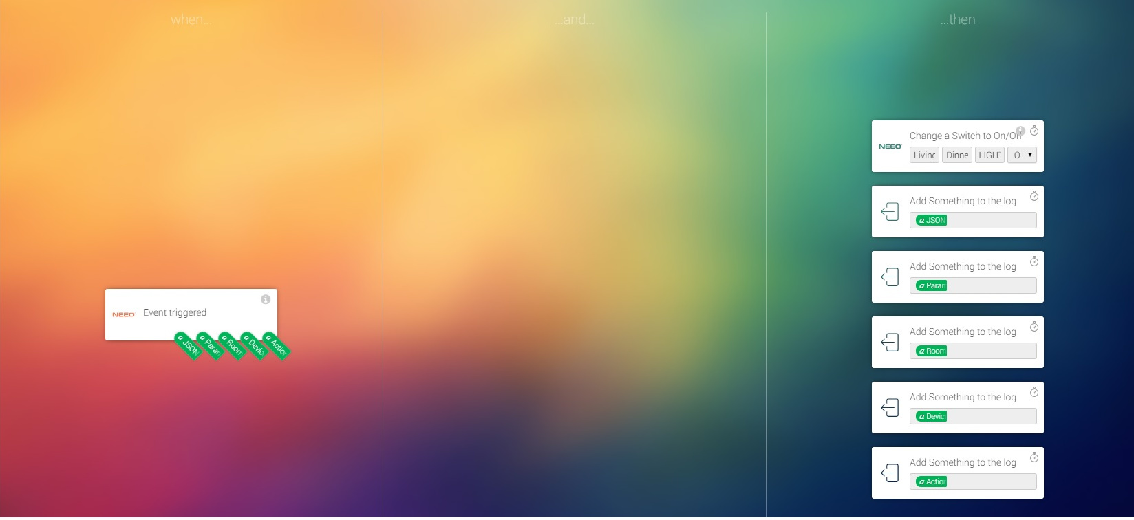

@Niels I’ve created the following flows. It works brilliantly.
Need to upload 2nd flow in seperate post.
Thanks for your help
2nd flow:
In this flow don’t use the change a switch card but the inform a switch card. what you are doing now is that when you set the value to o you also send a power off command opposed to only visualizing the power is off. seems similar but the one your using in this example is like using the neeo remote and press the switch.

@Niels
It is very clear now. I should have looked better at your flow cards. I’ve changed the flow, so it just updates the switch state like it should. Thanks.

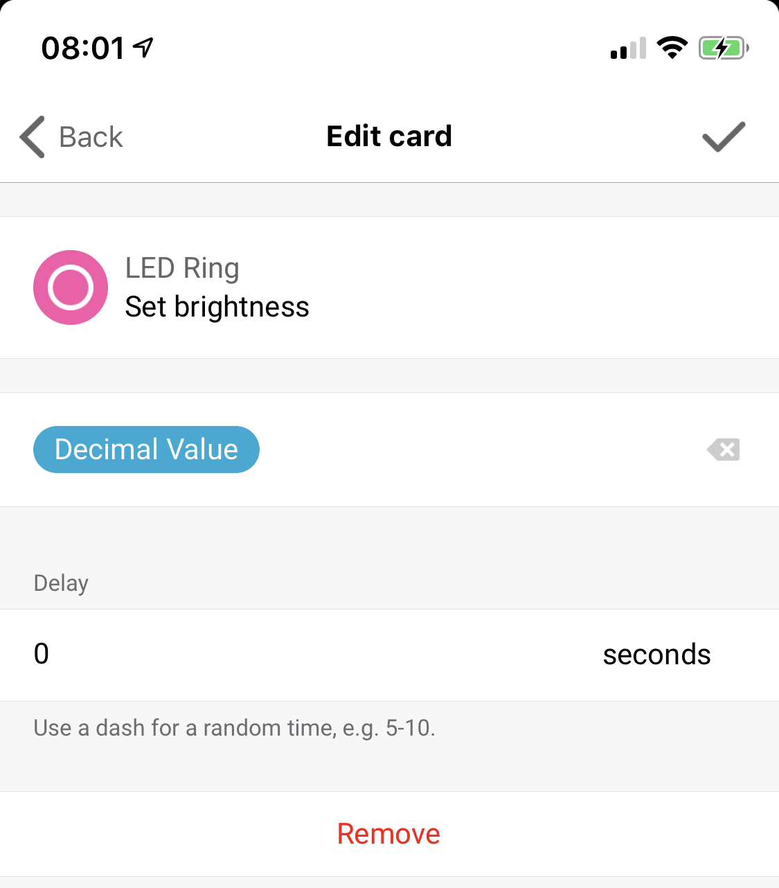

To use a slider set the NEEO card in the when field. Select when slider changed. In the then field use the lightbulb card that controls the brightness. The NEEO card gives off two tags (variables) one contains the actual value the other tag has the percentage (this is a decimal value between 0 and 1) you probably need the later tag inside the bulbs flow card. I don’t own these lights so I’m not sure what they accept.

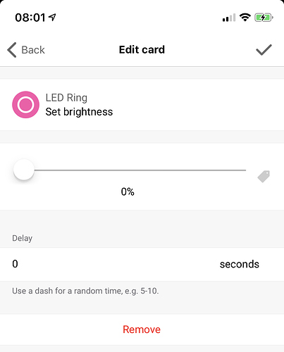

The thing about the slider controlling the Ikea bulb, is that I don’t see a tag in the bulb ‘then’ card. Acutally, this is not something specific for the bulb, since I also don’t see the tag when I try to write the slider value to a user variable. I am working in the Homey app since I upgraded to 2.0.0
Let me clarify the last part: I have a virtual switch in Homey (through add > Homey > virtual switch) that can trigger or stop a NEEO recipe. The thing is that I don’t see the option to give feedback to this virtual switch in Homey when launching a recipe from NEEO. In other words, when I launch a recipe from NEEO, my virtual switch in Homey remains off. Is there any means of feedback to this virtual switch, I only seem to be able to turn it on/off, which probably triggers the NEEO recipe again… Hope this makes more sense now…

I’ve built a slider to control the homey led as a reference.
image image
Interesting… I don’t get the option to use a “local tag” :thinking:
Edit: simular issue?
