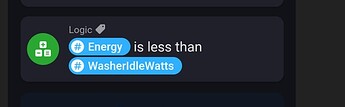

I have no earthly idea why this washer flow automation isn’t working but wanted to post here in case someone could help me out.
I posted my variables as well. I’m using an Aqara (US) wall plug.

Energy is not the same as Power, you can’t compare these two:
